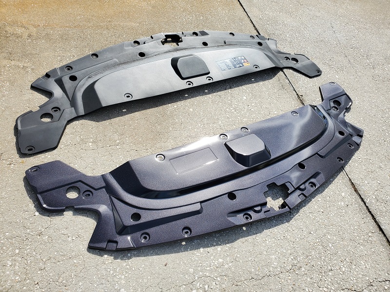

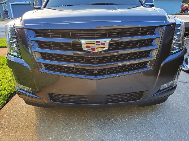

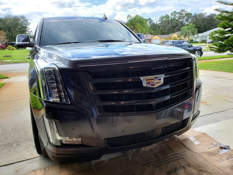

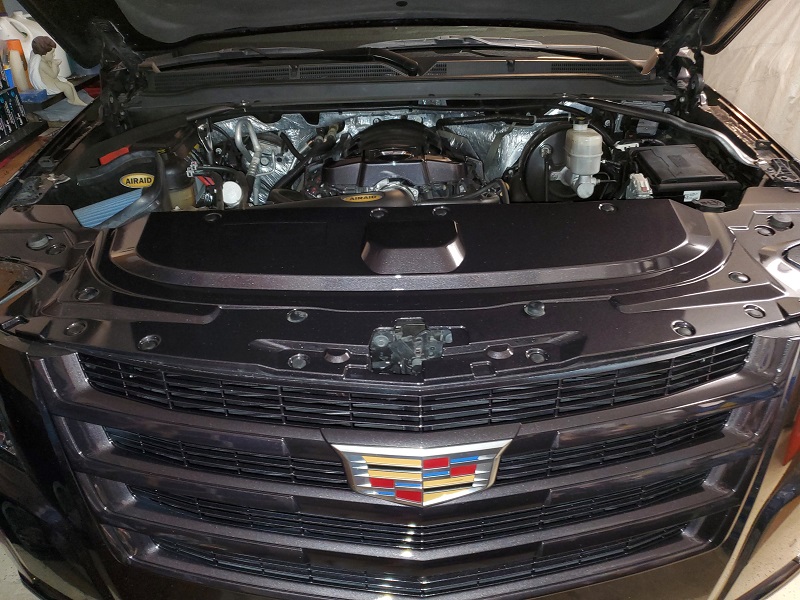

Basically an overall productive weekend. The color matched grill and other pieces had several chips that needed to get addressed. We worked on getting all of the pieces pieces prepared then color matched. Also installed the color matched radiator cover when we got done with the color matching effort this afternoon.
