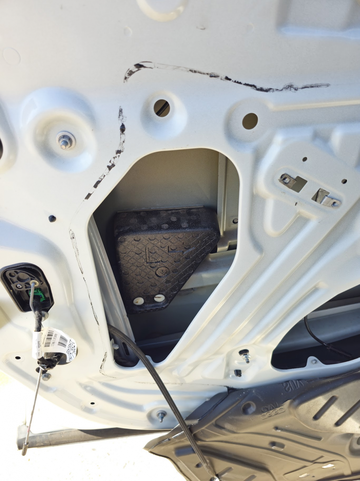

Took my door card off to replace the driver window regulator (I had expertly diagnosed a stuck regulator based on previous experience and absolutely zero investigating) only to discover that it was just the stupid foam block that had detached from the door skin and was blocking the glass halfway down. I looked around for awhile to see what I could re-adhere it with and ended up just putting a line of black RTV on it and squished it into the door skin. I guess I have a new regulator for whenever this one eventually dies...
