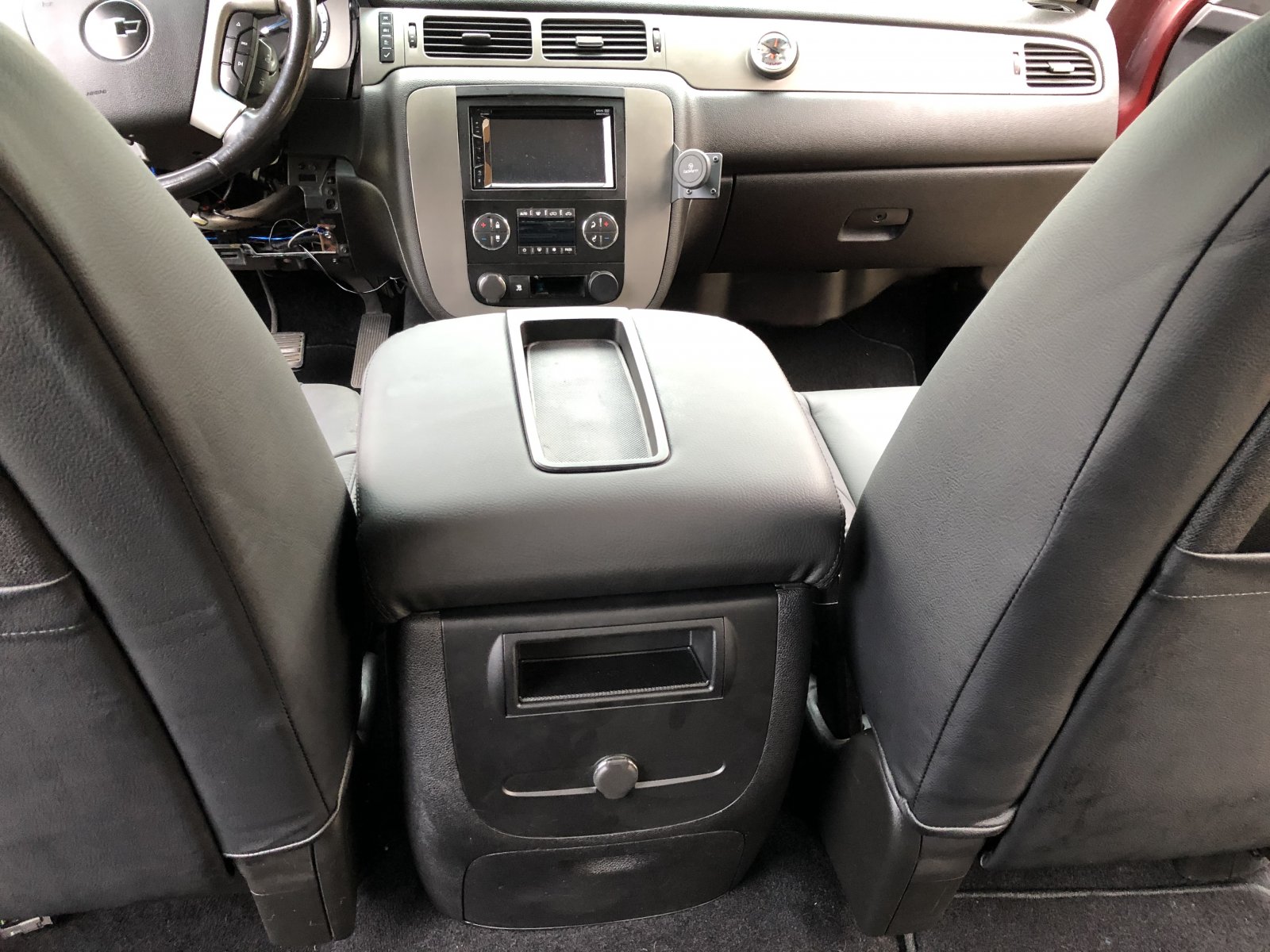

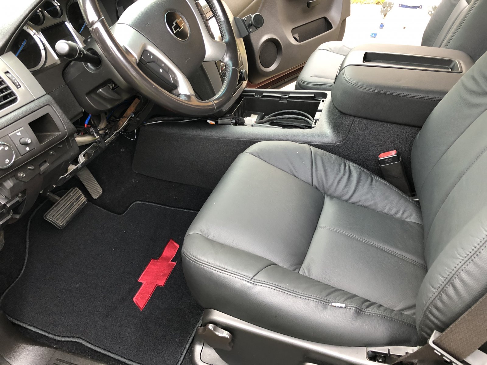

Technically not today, but I am one step closer to making my rear speakers work. After studying the wiring diagram for the RSE I noticed that the rear speaker wires go in and out. I cut into the wires and hooked a speaker into them and got sound coming out, so I know that the rear channel of the radio is still good. I don't think the speakers are blown because neither the rear doors or the D pillar speakers play. I am thinking the wires are broken or shorted somewhere between the RSE and the rear speakers. I didn't have time to pull the panels and run new wire yesterday. Probably tackle that this weekend or next.

I read a service bulletin that the wiring can become damaged in the B pillar by the seatbelt retractor. I have already pulled the covers in the past and seen no chaffing or damage. It appears that the harness leaves the radio and goes through the console to the RSE and back forward to the radio area. Just too much to disassemble and trace out. I will just run new wire since I can get signal right out where I cut the wires.

Someone already had the dash out to repair the cracking before I bought it, I thought the wires could have been damaged then so I decided to investigate the RSE approach.

No I didn't bypass it, I am just going to splice into the output of the RSE that way it still functions. I just find it weird that I have sound to the RSE because the headphones work and output wires give sound but none of the rear 4 speakers play. Has to be a major break in the harness somewhere. Although I didn't have a fully functional test speaker, just a 2 way that the woofer was blown but I did get sound from the tweeter when testing the output.
