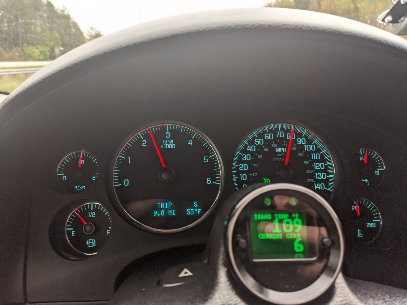

Bummer. Hope it's an easy fix. Maybe sending unit?
Edit: that code relates to a bad battery, alternator, or power or ground cable.
With a Tech2, you can change the tire pressure setting for alerts, if the tire falls below 10 psi of the setting it will let you know via the DIC and the light. It also let's you tell it what kind of tire you're running, but I have no idea how that information is used. Would love to know though!
Yep, simpler but then you have to air them up and even them out afterwards! We can do it their way via Tech2 and that tool as well.
GMT900s don't have that code. If you have another code reader or scan tool see if it pulls up something else.
I thinking sending unit.
And I think its suppose to be 0523. This isnt the 1st time the idatalink has given the wrong code being 1 number off.
Going to order a sender and screen today. Going to the beach Friday and I want my oil pressure gauge to work during that drive, lol.
