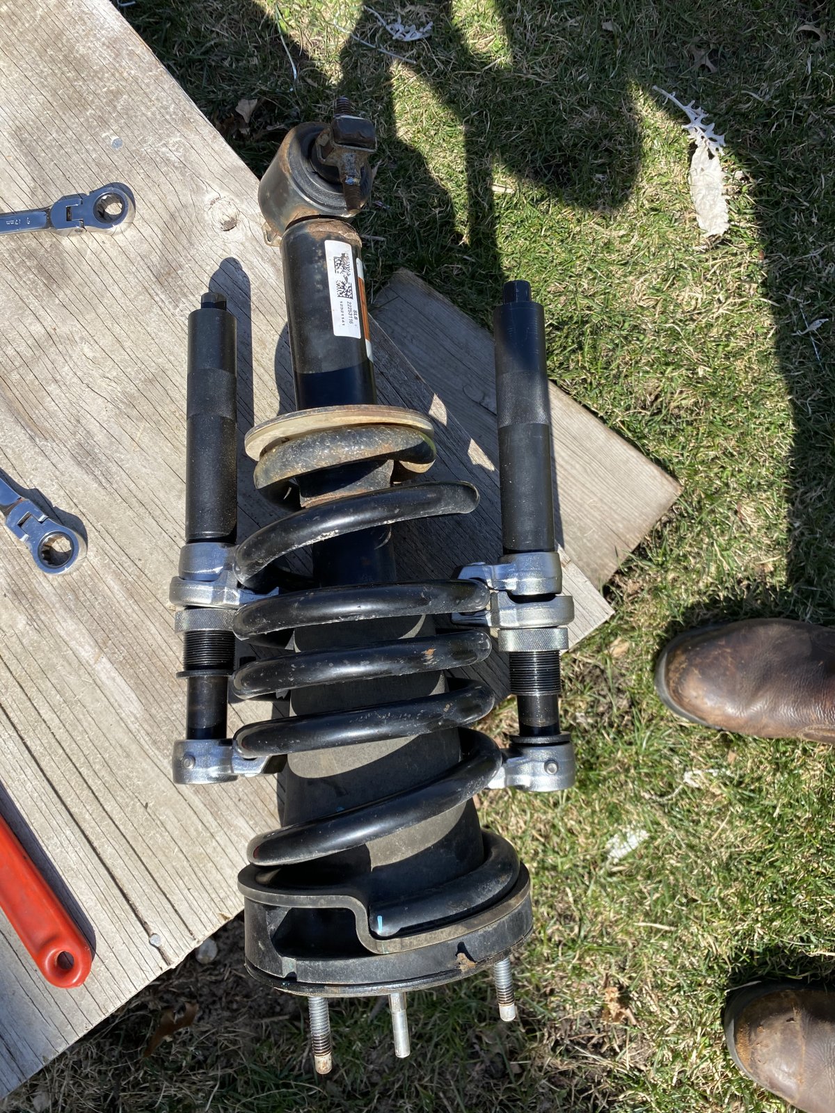

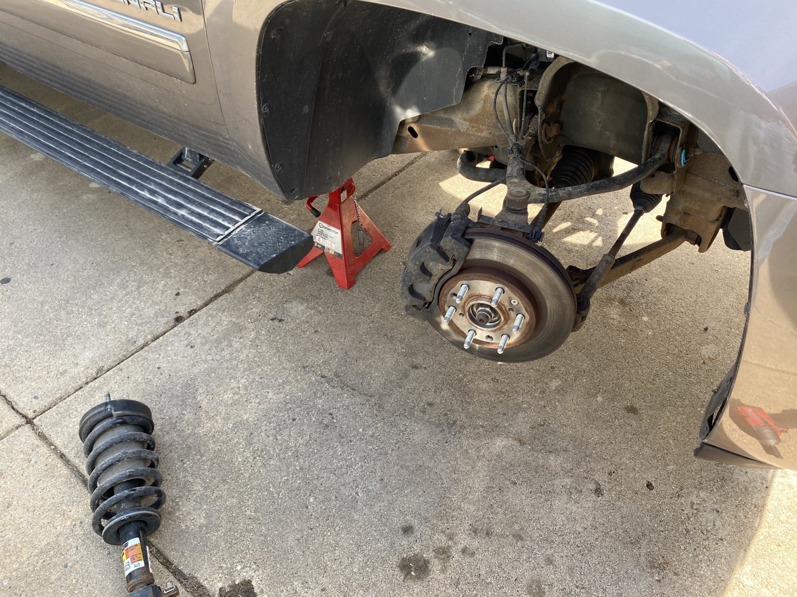

Free travel mod and helper bags installed on the beast !!
e6726b4dfe19f999c8c18dd8b4fdbb74.jpg797033e8a6400863b88fb9d56ff47c02.jpg38846ad1373f6e3a779b8f71dedd860b.jpg
