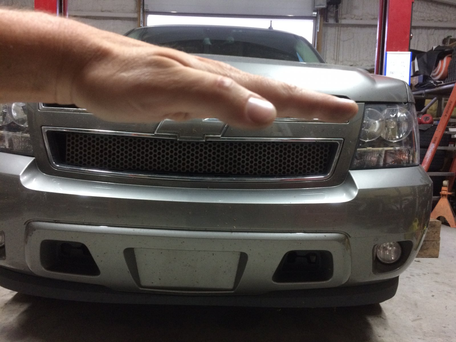

Lemme "grill" y'all for a minute...
I dug out two candidates for "custom" grilles. I still may not use either of these and may pick up a sheet of stucco mesh since it's easier to work with. Whichever I use, it'll be painted satin black and recessed deep. I'll make two small matching ones to go in the tow hook holes. I think I know which one I like best, but the other gives me doubts. They're not such a concern, but I listed the stats for fun. What y'all think?
Contestant #1. Perforated mild steel, 1/16" thick, 1/2" holes on 11/16 centers, 48% open area:
Contestant #2. Aluminum, 1/2" #16 flattened expanded, 64% open area:
I vote #1.
