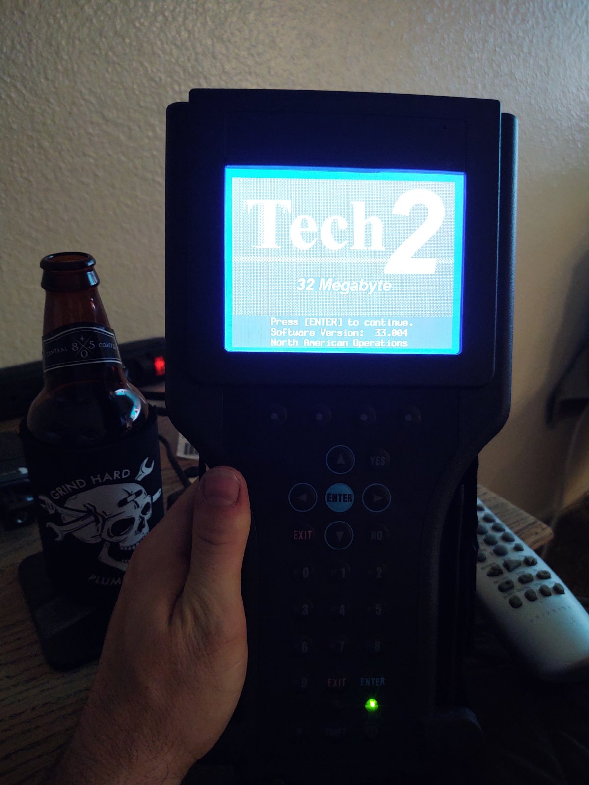

Hooked up the tech2 and inflated the shocks to 18psi I will let it sit a while and see if it changes, I sprayed soap/water all over don't see any bubbles so far
***edit only been 10 minutes lost 4psi already but can't find the leak :mad:

It might be the pump, I have a spare T connector and so I looped it back to it's self and it still looses air but even faster and nothing on the T connector is blowing bubbles, I sprayed the whole pump and no bubbles there either i don't know where the exhaust port is on this thing
