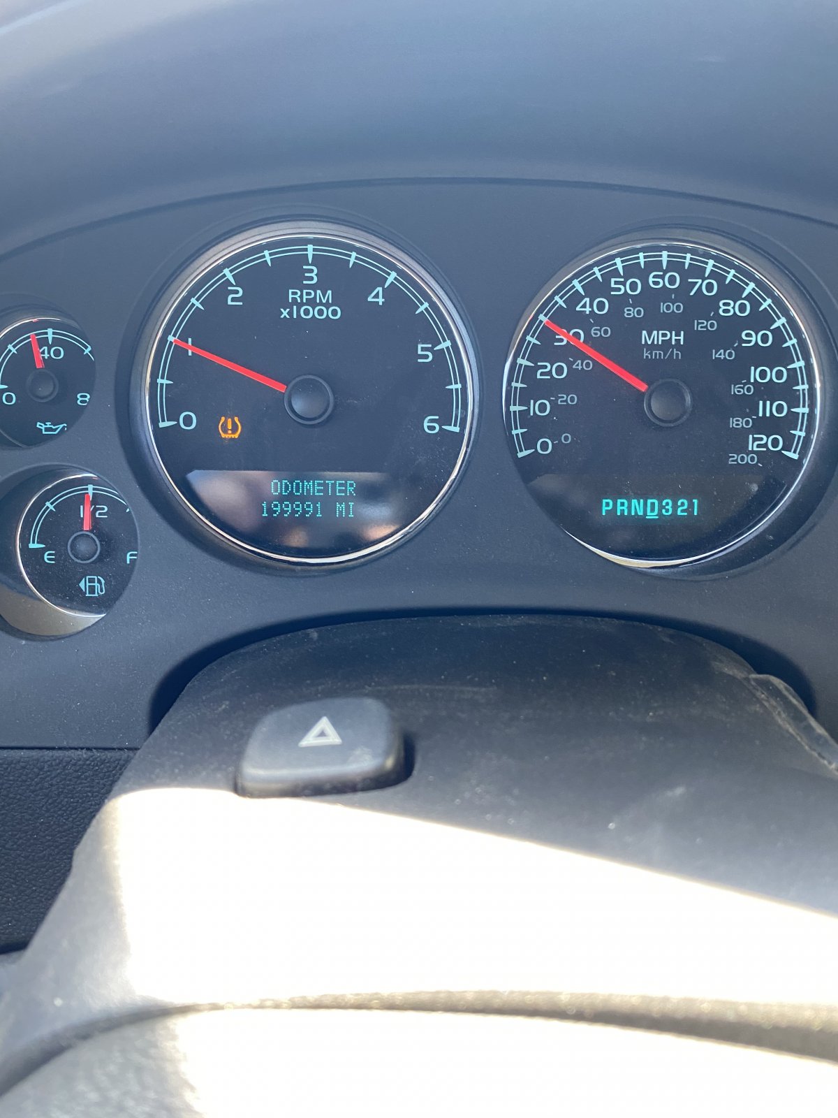

I have never heard of that method. How does it work?
It just makes it easier to see what MPH to put into HPTuners for upshifts. You have to put in a MPH and an RPM for each gear and a shift speed and a shift pressure and whatnot. Biggest thing is mph and rpm.
They’re not matched though, because the ECM/TCM aren’t fast enough computers for that. First it watches your speed, and after the specified mph is reached then it looks at engine speed, and once it sees that at whatever throttle percent you’re at, (separate table for partial throttle and WOT) then it will actually start your shift. Then you have to take into account with the shift speeds and pressures that the 4L60e is a slow shifting transmission, and the ratios are far from close, so you have to taylor your settings to that (and to some extent the mph/rpm splits for that as well.
This might not sound like a lot going on to you but it does to me. Especially because I’m not a tuner, which is why recording the cluster helps me dial it in.
I’m glad I let Blackbear tune mine, they dont require me to record anything other than a datalog of me out driving around which is stored in the Autocal and emailed to them. As far as a 4l60 being a slow shifting transmission, that’s only the case in its stock configuration and with torque management. My level 3 Performabuilt shifts fast and hard, faster than I could if it was a manual. Torque management has been removed. I’m sure the converter matters as well, it’s a triple disc billet by FTI with 2800 stall.
