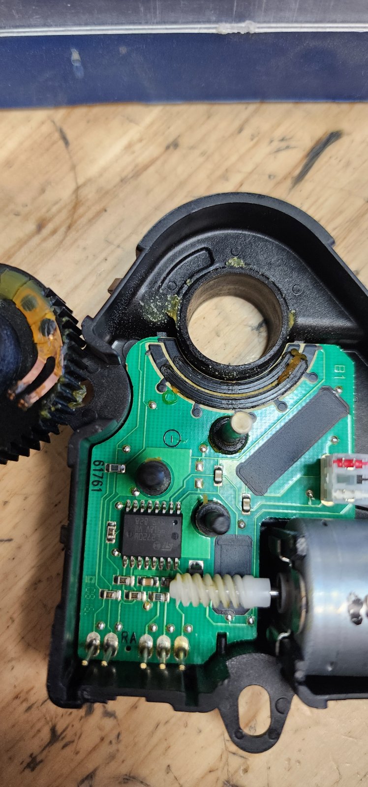

Got my mirrors cleaned em and tested them and amazing!! Need some heat in the air to put them on though. Soooo cold here.
I can’t seem to find a set of paint matched handles and really don’t want to paint them. I have an idea though and want some input. I was wondering if the center of the handles are the same on all handles? To me it looks it and the main body of it houses the unlatching mechanism. I’m waiting for a single handle to show up and test but want some input before I dismantle it and mine to make one paint matched handle.

Well I got bored and put my mirrors on. Quite happy they both fold quietly and looks brand new but aren’t. Also I gained a cool feature in the process. Auto darken like the rear view. My mirror previously didn’t have that. My Holden does and love it so I’m happy I got it.
