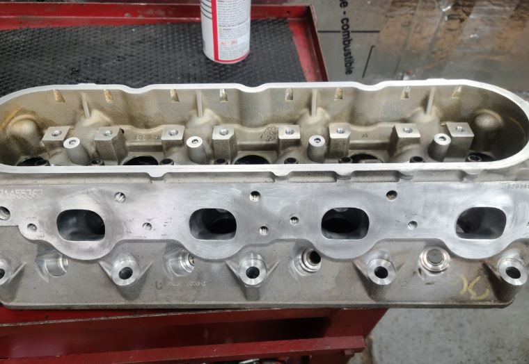

Got the other head cleaned up and assembled.
I did a waaay better job on this one.
Now i think i better redo the other head so i don't have an imbalance or something anoying.
:D
And i have one head bolted down.
Used tie-down straps to pull the exhaust manifold out of the way to get a torque wrench in there.
The degrees thing...
Stretching the bolt should make up for minor imperfections i hope... :rolleyes:

Do these motors have torque to yield head bolts?
Any motors that I've had the heads off I've replaced the bolts with either ARP bolts or studs if I plan on running boost. They're reusable

Good luck. Hope you don’t get a leak.
Crossing my fingers lol.
I didn't go too crazy with the head cleanup, mostly focused on cleaning and preventing carbon from sticking.
Before installing, i did a slightly better job around the spark plug area.
I didn't grab a picture tho....

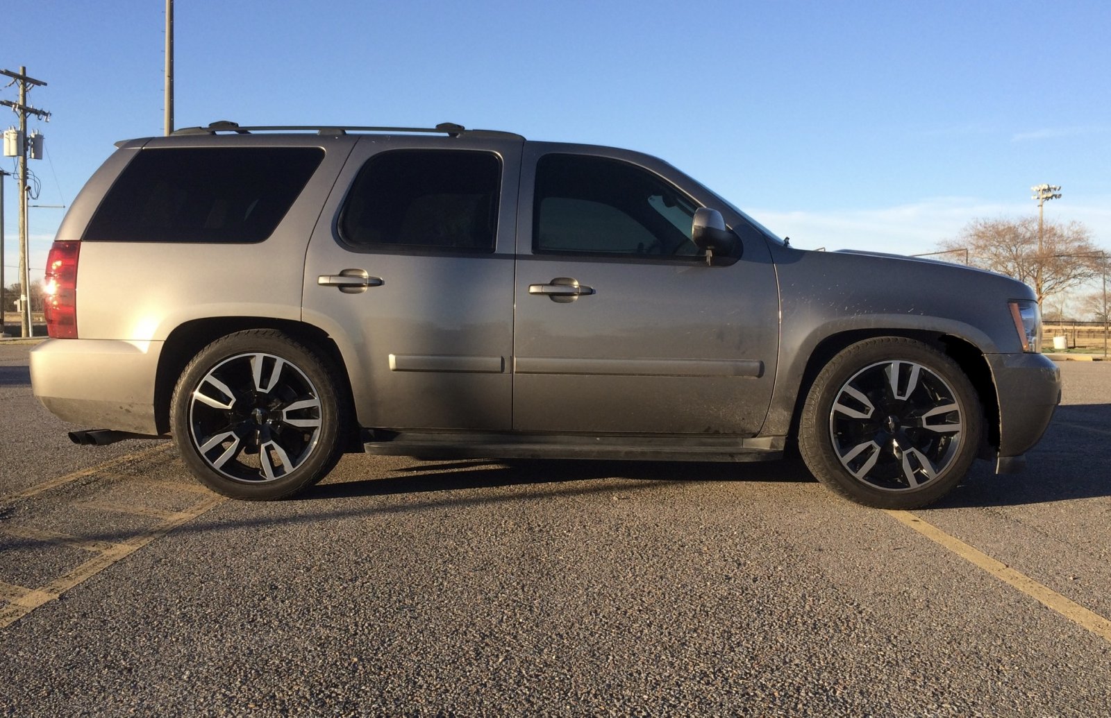

Um...By look at the second photo I think you may have a problem with your suspension. Or you could just have a sick set of air bags installed on er’. Lookin good!
Has a nice stance, looks good. :cheers:
Nice. Now id end up forgetting to leave it aired up and come out one day to it frozen to the ground :eek: :rofl:
...Y'all do know this is a photochop, right? A buddy sent me a link to an app: "Suspension Master"
Sometimes, I wish it really was 'bagged.
