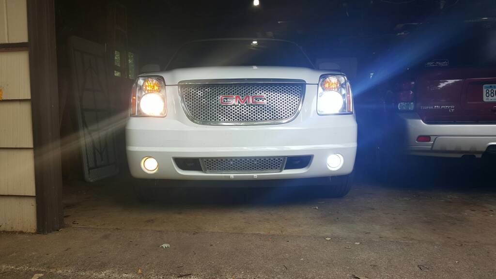

Wired in my Jatronx relay to my passenger headlight. This was prep for my HID Christmas present.
Wired mine a little differently. This will only feed power to the headlights when there's power to the headlight switch > 13.5 volts or if the headlight switch is powered and the override on the relay is powered. Thought I was clever when I wired the override to the tow/haul circuit. Turns out the tow/haul circuit isn't a 12v circuit, it runs at some lower voltage. So back to the drawing board, probably with a switch under the dash.
Relay behind coolant overflow
Wiring under airbox
Terminates behind right hand headlight with disconnects to reroute low beam power
All wrapped up
Here's my blue wire run to the tow/haul button. (FAIL)

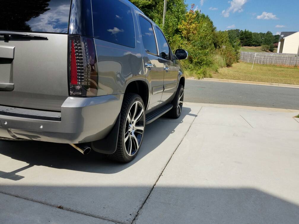

Took the roof rack off and put new wheels on. Before and after pics, had windows tinted awhile back.

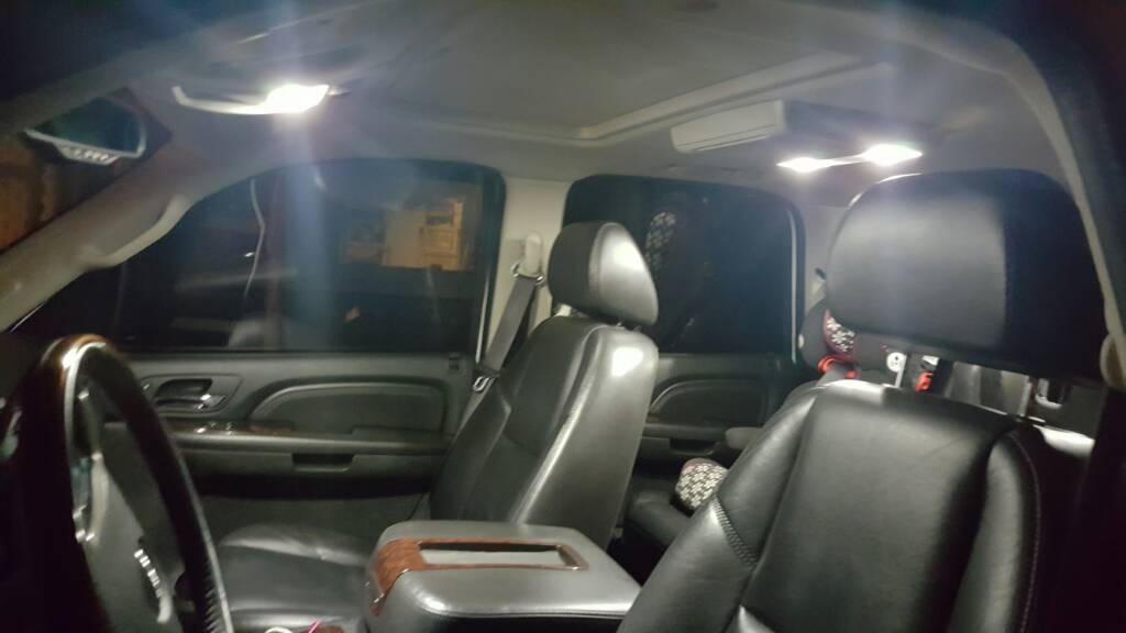

I got around to putting in a couple of hydro dipped pieces I brought from NathanJax. I'll probably put the steering wheel pieces in this weekend.
