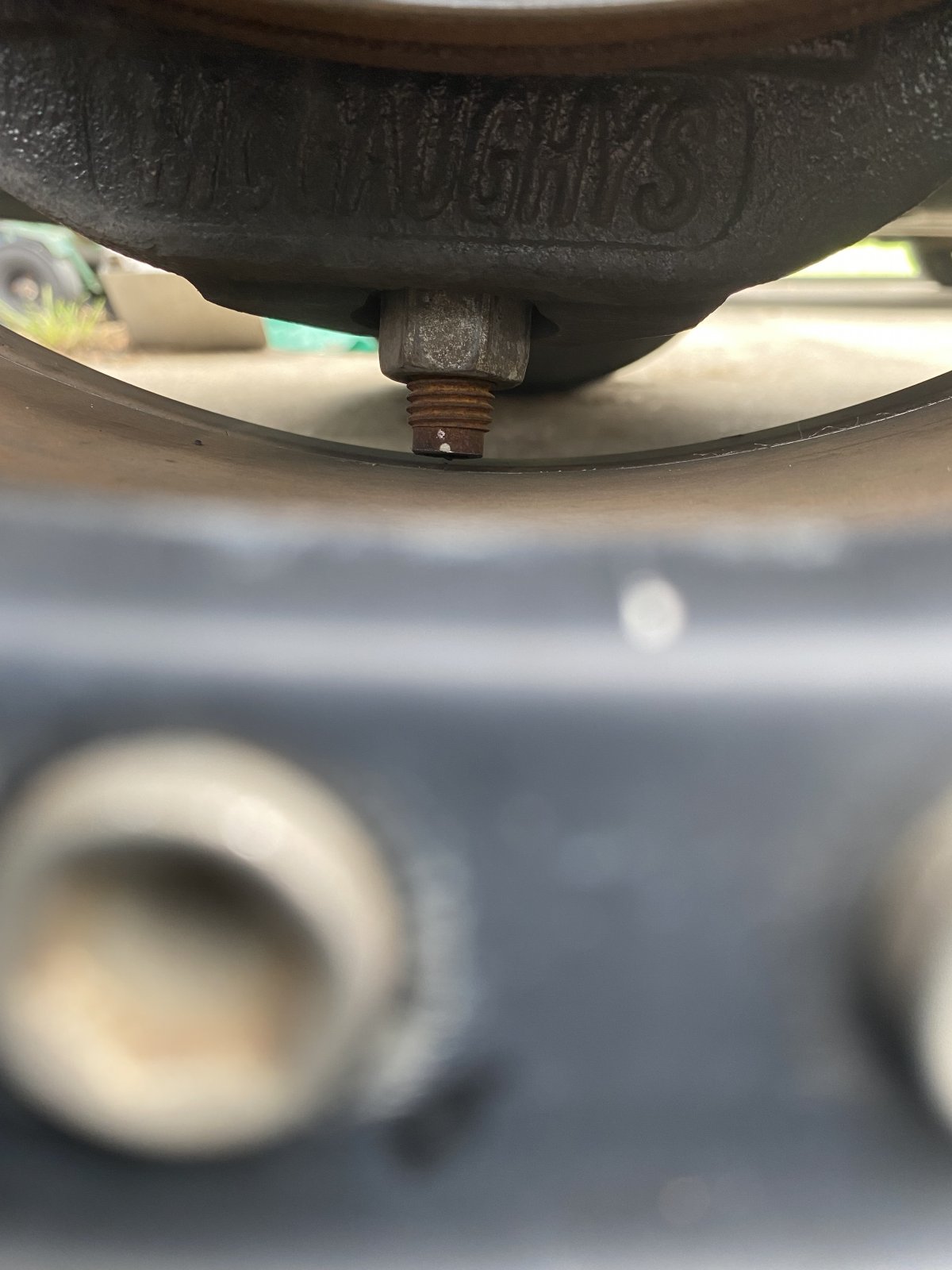

Borrowed these wheels to take the declads off to have the tires replaced. These were on his Tahoe when he bought it. We call them the "Uggos":
They're 18". He had to trim about an inch off his lower ball joint stud, which included shaving some off the nut. I guess this is due to the Belltech spindles? Mine BARELY contacted the rim. I shaved the thickness of the death disc (1.14mm or 3/64") for adequate clearance:
