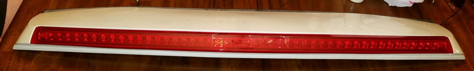

Noticed a wet spot in the back carpet in the Denali last night.
Put the hose on the car and water leaks into the car between the plastic covers (rear back up proximity light indicator)
Does this mean the roof rack leaks?
Any easy way to drop the head liner?
JML07denali
Mar 23, 2014
873
365
Mine was leaking as well. I opened the rear hatch and found out that water was coming in through the large black plastic booth where the wires run through for the 3rd brake light. I bought some clear liquid nails and made sure it was secured tight. I have not had a leak since.
