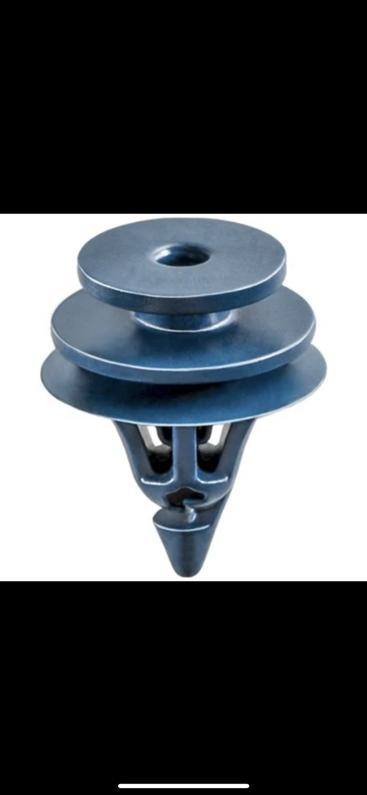

Any of you guys know where i can find a generic version of this clip? The back plastic trim on the headliner close to the tailgate is hanging due to this broken clip. GM wants 5 bucks for 1 clip and i know i can get a pack of 30 for 5 bucks.
GM part number
11561654​

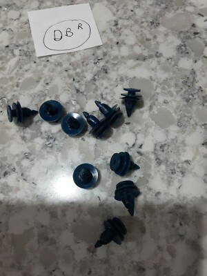

GM part number
11561654​
Is this what you’re looking for?
