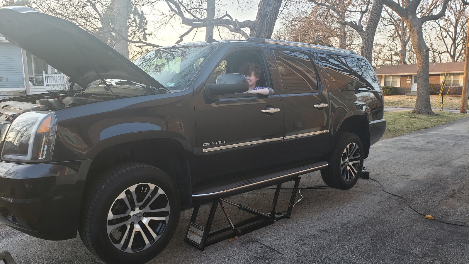

Oil and filter change. Did it in the driveway and put it up on the QuickJack so I could also roll round under it and spray parts of the underside with Surface Shield. I'm surprised that all the new control arms and tie rods are already getting that powdery light brown rust coating on them. It's only been about 4 months.
I had my daughter climb up in it to reset the OLM and take the obligatory picture

I'd prefer a lift, or even one of those MaxJax, but I didn't want something that had to be used in the same spot all the time. I have too many vehicles to have to move around to use it. With this I can use it wherever, anywhere in the garage or driveway.
I have the 7000lb extended length model and it isn't light, about 100lbs per unit, but it has wheels on one end and can be rolled around pretty easily, except for the length makes tight turns a bit difficult. The hydraulic hoses have quick connects and don't leak any fluid when connecting or disconnecting. It lifts 24" I think and I use the truck adapters which also give a few extra inches. It's hard to tell, but there is about a full foot under the tires and almost 30" from the ground to the bottom of the oil pan.
