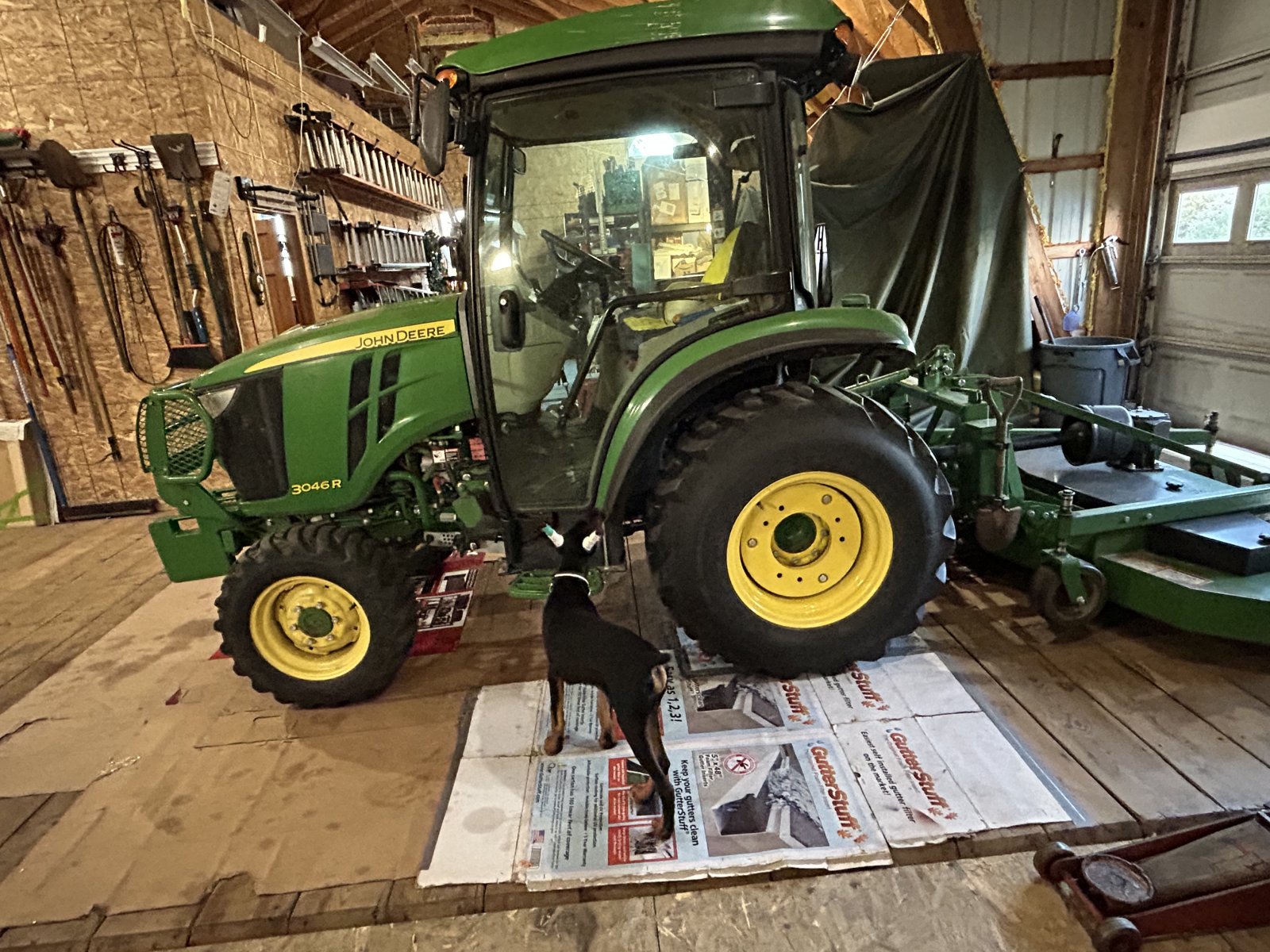

Walking up to my workshop this morning I see this, which is a bit of a shock to me since my Denali sat up here for the better part of two years. Granted I’m the one who pulled my tractor into the barn last night so I could grease it up this morning, but it was still a surprise to see this green beast instead of my Denali or an empty space.
And damn is he getting big. At just over four months, he weighs more than my wife’s dog and she’s a year and a half old. He jacked his posts up while sleeping last night so I had to cut out the middle brace this morning.
Now lets go make some braided -6 AN trans cooler lines!
