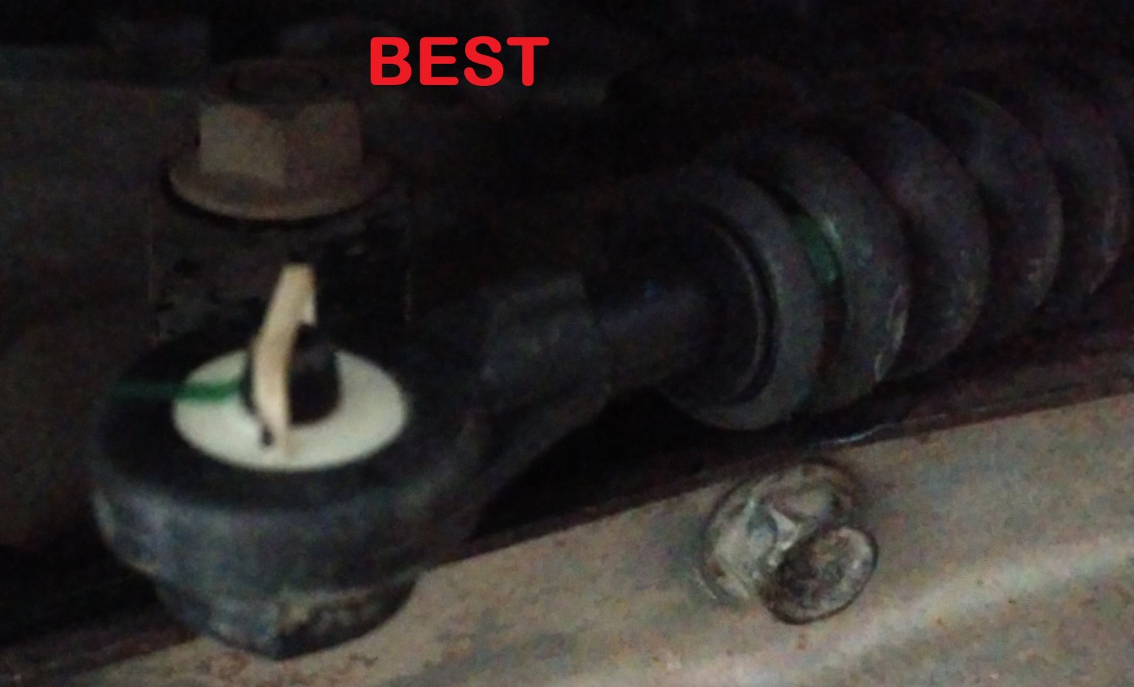

Back in April my lower shift cable failed. The first attempt at repair was a failure. I tried part# 14104 link bushing by Dorman. Do NOT use those.
The second attempt worked, using Dorman #14073 with a snap ring and washers (spacers) I picked up from Home Depot. After 6 months it started to feel like that plastic was getting weak and might fail.
I went ahead and bought a lower shift cable from rock auto and installed it. It was an easy install. There are a couple videos on YT that are pretty good and several that are not.
Second fix. This was before I decided to put some spacers between the cable loop and the snap ring. I felt the gap would create problems.
Final fix:
Final fix:
For some reason my cowl didn't have a weather strip / gasket when I bought the vehicle. I pulled one from a yard and finally got around to installing it
I used this one and a washer plus a cotter pin it's been fine for over 3 years now
