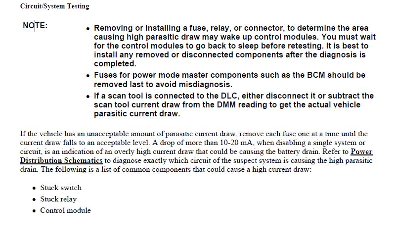

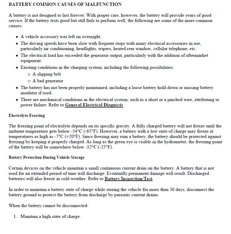

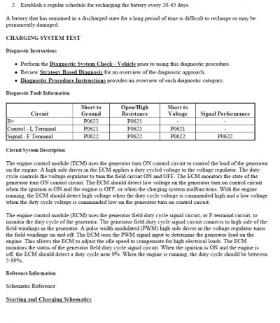

I would guess 1 of these things is happening
1. bad battery
2. unknown/unmetered draw/short
3. poor charging
I would start load testing each battery separately, but to me whenever a battery has been drained dead even by accident then it's never the same again
then check charging to each battery, put a load on the system by turning on everything that you can and see what the alternator is putting out to each battery.
if that all checks good then check for a draw while everything is asleep, if there is a heavy draw then starting pulling fuses.
