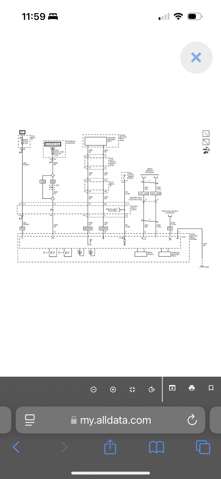

the mirror harness on my 2012 wire colors don't correspond to anything I can find online, not even close other than power & ground....
Most online info says gentex mirrors use pins 6&7 for temp data, my harness has wires already on 6&7 I guess I need a mirror wiring diagram for a 2012 Yukon @mikez71 ?
Best I could do with my phone
27,706
42,112
that shows 6&7 going to object detection, which I assume is blind spot detection? but there is no indicator in the rear view mirror, that is only in the driver and passenger mirrors.
this vehicle doesn't have any kind of lane keep or any kind of camera for emergency braking, rain sense or anything like that at all.
***edit, looks like maybe DRC would be if it had the backup camera display in the mirror, vs it being displayed on my radio, in which case the wires are not in use and I can just connect a ambient temp sensor to them (guessing)
