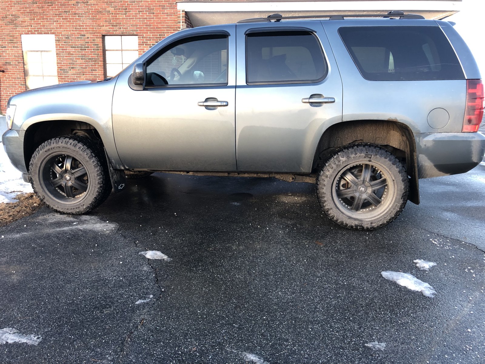

I decided that I'm going to take the leveling kit off and go with a DJM 2/3 drop.
I also just bought these and going to sell my stocks with the 285's
I'll post pics of the rims installed as soon as I get them on :)

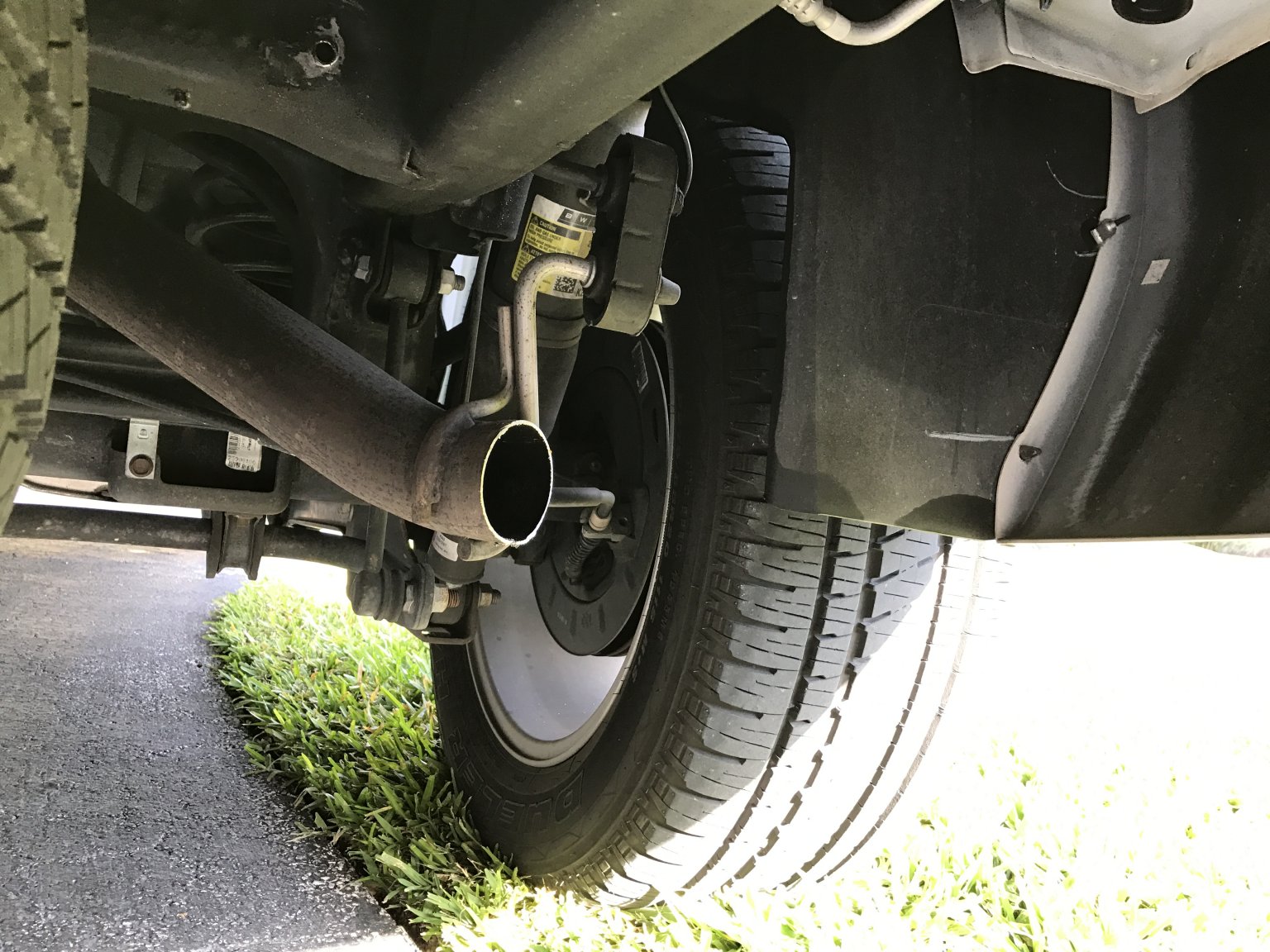

Sounds sweet! I guess the resonator doesn't make that big of a difference as far as being too loud. Can I just cut it off as close to the resonator as possible and get a new tip that exits the side?
@mdhawk
I did this to my 2013 Suburban. I am likely going to get a tip welded on out the side or you can just buy the SLP resonator delete kit. $125
http://www.slponline.com/product/31...-Yukon-XL-53L-Dual-Tip-Tailpipe-Assembly.html
Fosscore
Apr 16, 2014
10,557
18,431
Absolutely zero change in sound while revving, driving or stomping on it. The only difference is at start up, there is no burble since the resonator is gone. The wife has not even noticed and it is her daily driver.
The SLP kit is perfect for this mod, but needs to be cut a few inches towards the front of the truck on the other side of that hanger. I am still unsure what I am doing at this point with it or just leaving it as is.

There are many posts about the SLP across this forum and others. It is the simplest bolt on mod after you cut off the OEM resonator. @ubervic and I went back and forth a couple times about this. I cut the resonator off and then he installed the SLP. A few other guys recently have done it as well. Those double tips look really nice in place of the OEM boring tail pipe.
Here's another thread on it.
http://www.tahoeyukonforum.com/threads/slp-resonator-delete.72464/
08HoeCD
May 6, 2016
2,052
1,931
Yes, I highly recommend the SLP kit. The install is easy, especially if you jack the rear up off the ground in order to get a clearer cutting path with a sawzall. (I was somewhat lazy and did not jack my truck up to do the cutting, and this allowed precious little space to maneuver the sawzall blade up to the cutting point, but not terribly bad.)
I was pleasantly surprised to notice a bit more throatiness at start-up outside the vehicle after installing the tips. I can detect just a very minor change in exhaust tone/loudness while driving----maybe only a 5% difference, and nothing to brag about at all. But the look of the tips alone, versus that ugly resonator, is worth the price. And you can install it yourself. WIN.
Thank you for the feedback and pics. I'll add that to my to do list now.
