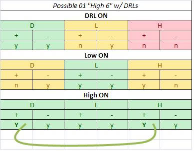

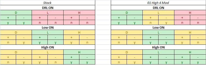

I've actually drawn up a logic table with the +/- circuits and current to each light based on many wiring diagrams and a little thought, here's what I've come up with so far for how the "SUPER EASY" 4-hi works on 01s, and then a draft of a potential bridge that would allow a "DRL hi 6" on my model year. Green cells have an active power and ground, meaning the light is on, yellow is either power or ground active, red is both power and ground switched off. Is this right?
If I am correct, the DRLs have a constant ground with switched power, while the Low and Highs have constant power (in the headlight ON, non-DRL state) with a switched ground. That's why providing a constant ground to the Low beams works for the 4-hi mod. If this is correct, you should be able to bridge the high-beam power to the DRL power (which has constant ground) to have the DRLs come on with the High beams. If you already did the 4-hi mod, then it would look like this for the 6-hi . . . would this work?
