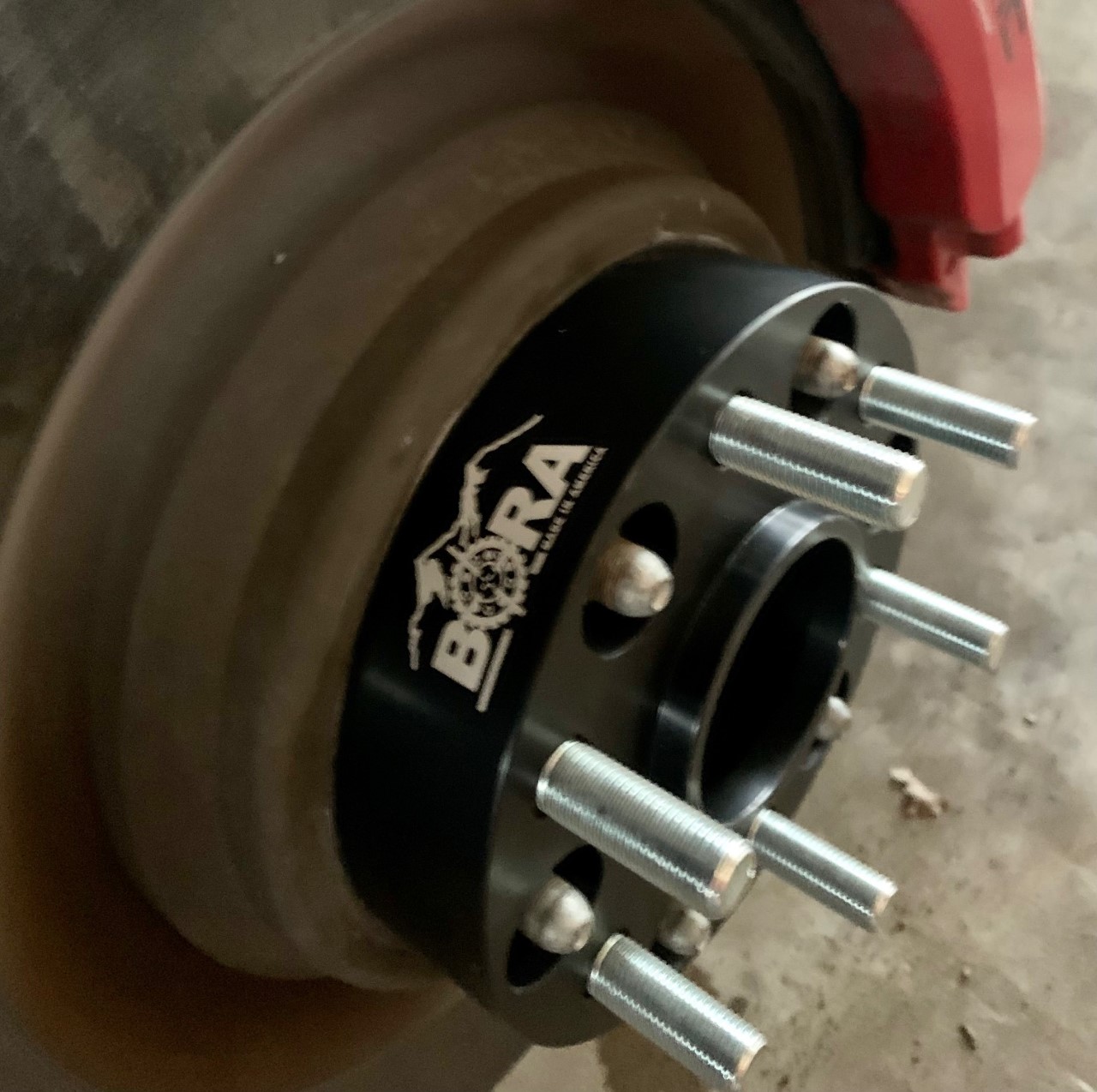

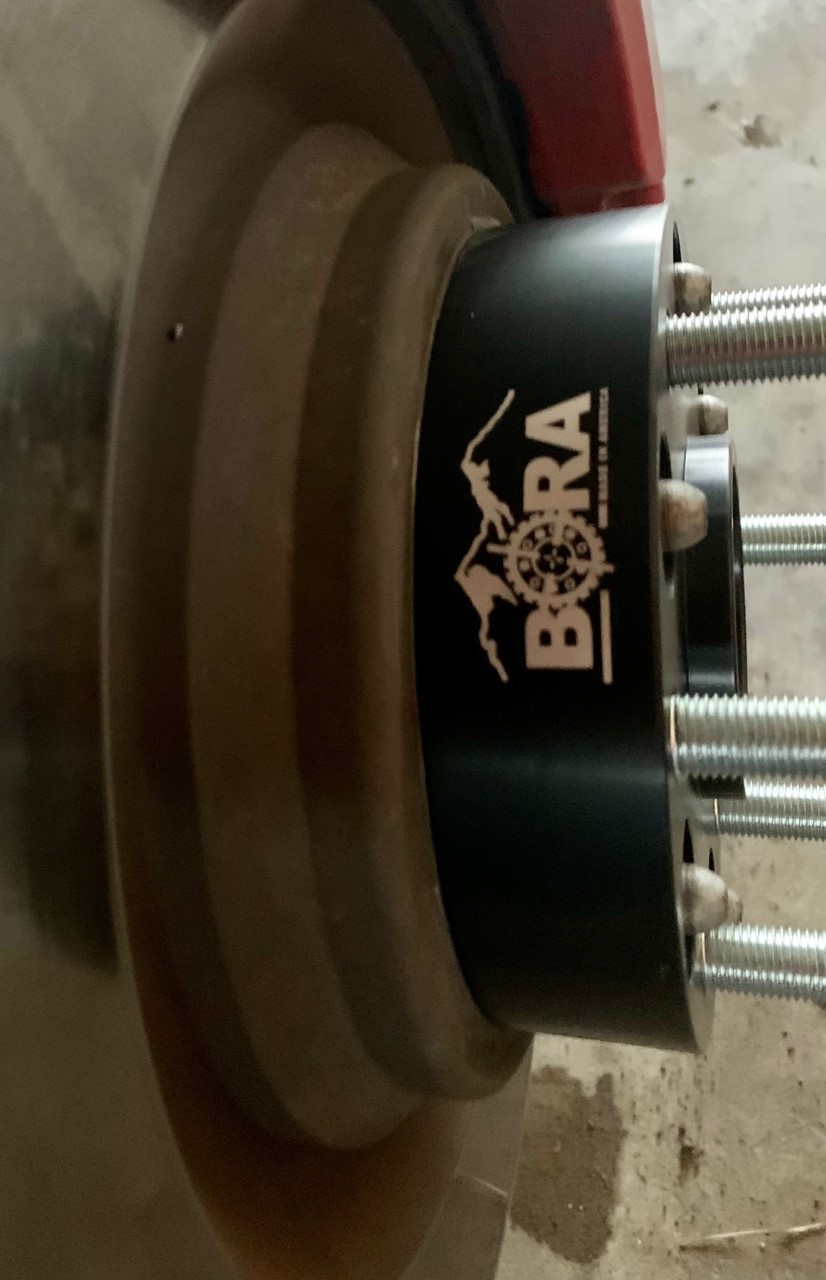

Thinking about potentially adding some BORA hub centric wheel spacers. Does anyone have experience with and/or know the smallest spacers that can be run on these wheels without cutting studs?
i place order for Bora 1" spacer and receive my order 27 day's later.One 1" spacers need to be cut but should look nice

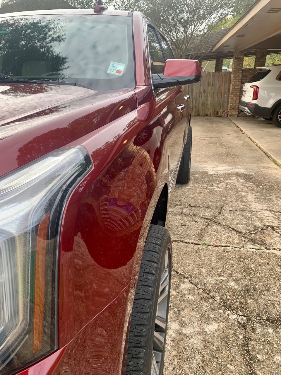

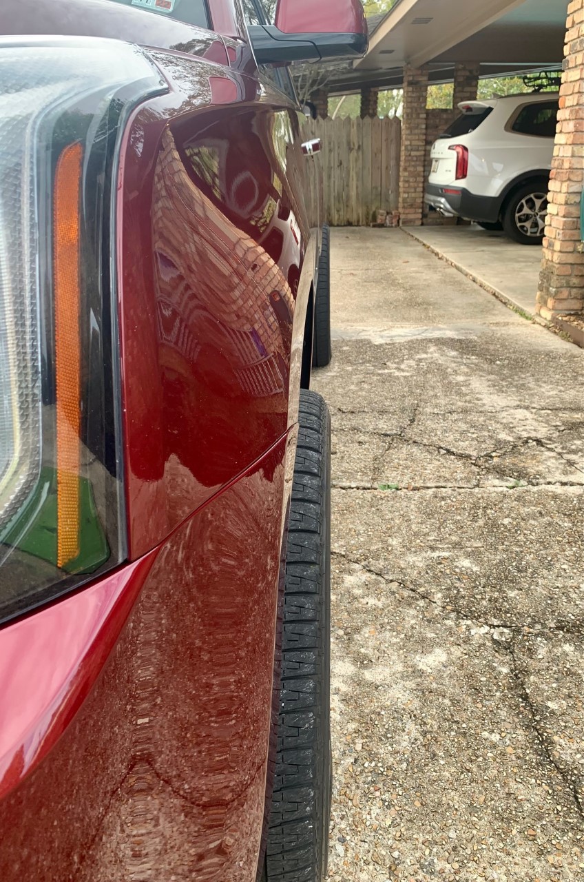

Looks damn good man, my only concern for putting 2 inchers on my GMC yukon with AT tires is messing up that paint. Have you ever received this problem? Keep in mind I go off-roading all the time, will this present me any problems? unnamed (9).jpg
