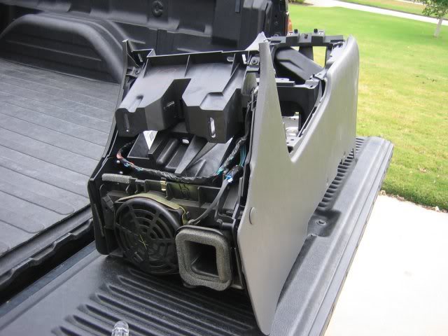

Right under the console. Under the storage part.
There is the sub, on the left. Right thing is A/C vent for the pickup trucks.
