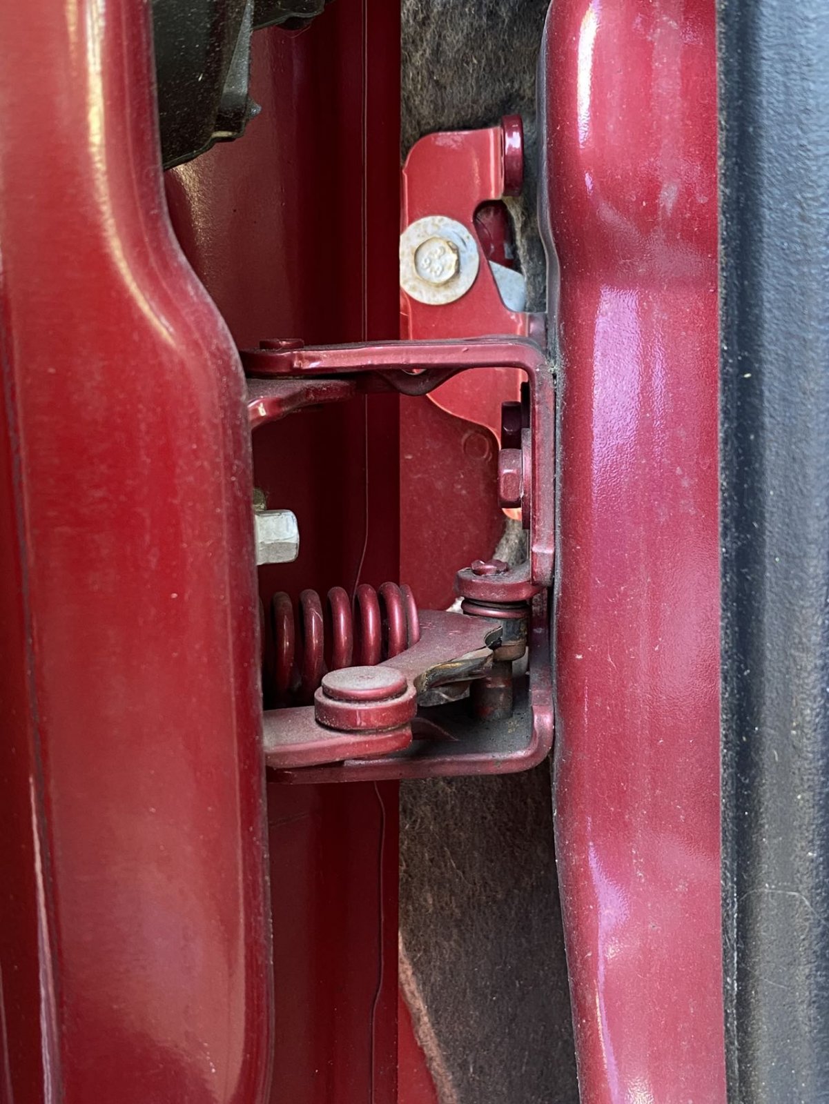

Hello,
The hinge is cheaper than roller pin. Should I change the hinge? Is it easier to work on hinge?
If I don't fix it, will the door be damaged? If it is only noisy, I will leave it for now.
Thank you for the advice.
Regards.

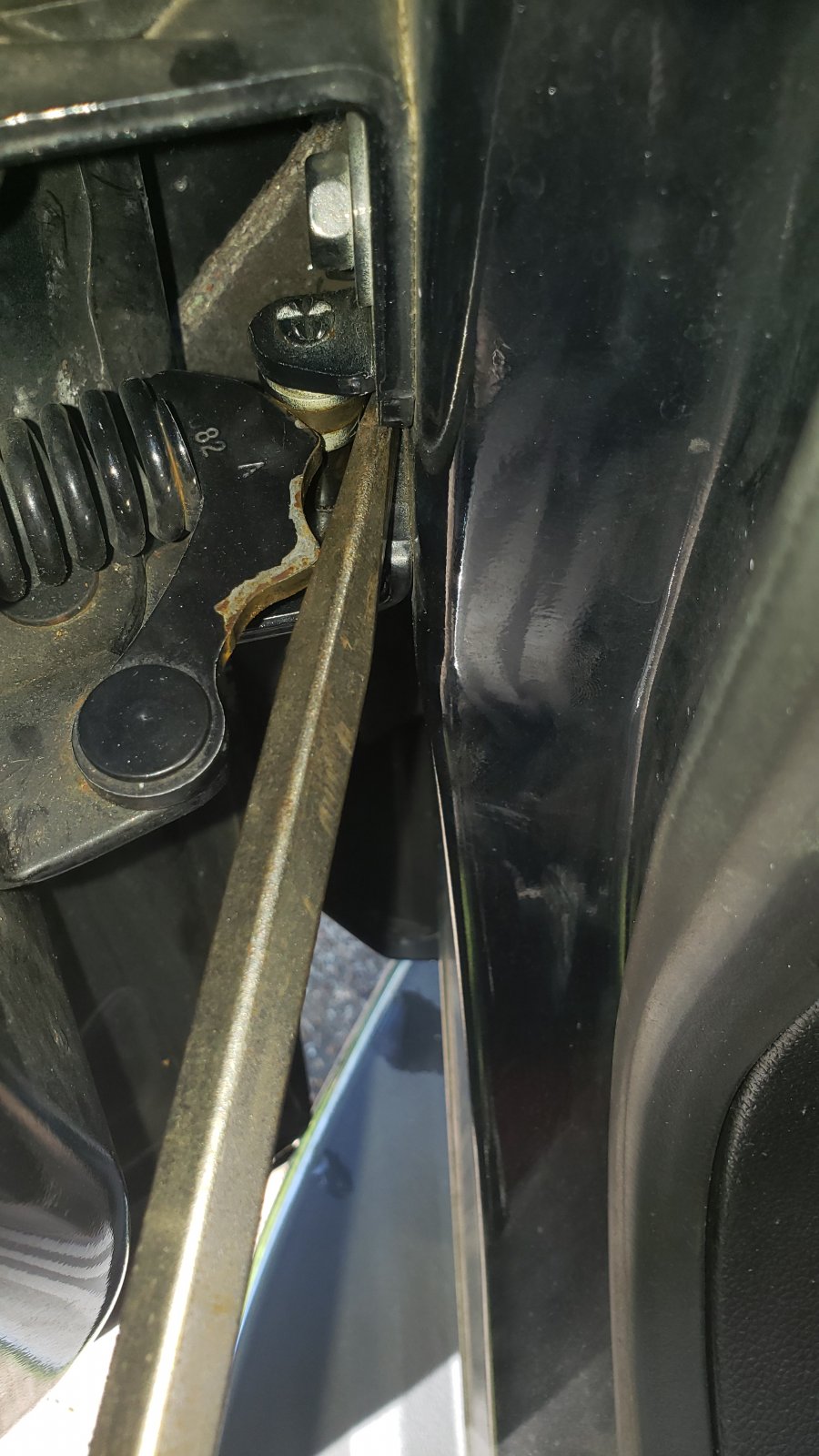

Unless the roller is actually broken/cracked then usually what happens is the hole in the roller where the shaft runs gets gunked up and keeps the roller from rolling. Then the sprung hinge part that rides on the roller slides across it, creating the noise.
I've found using something like brake parts cleaner in that area to get it cleaned up so it's rolling freely again, then using a dry lubricant on the shaft only (not on the roller). Also I'll use a pry bar or large screwdriver to press against that notched sprung part to hold it slightly off the roller so I can spin the roller with my fingers to help get the gunk out and the roller freed up.
EDIT TO ADD PIC
Here's a pic of how I use a large screwdriver to take the spring pressure off the roller to be able to roll it manually with the fingers of my other hand. Pushing screwdriver handle outward toward door will press the detent plate away from the roller.

Thank you all for the advice. My roller does not rotate any more. The pin is kind of bend so the roller sticks.
I will try to push spring away and try to rotate the roller. Appreciate your kind help.
