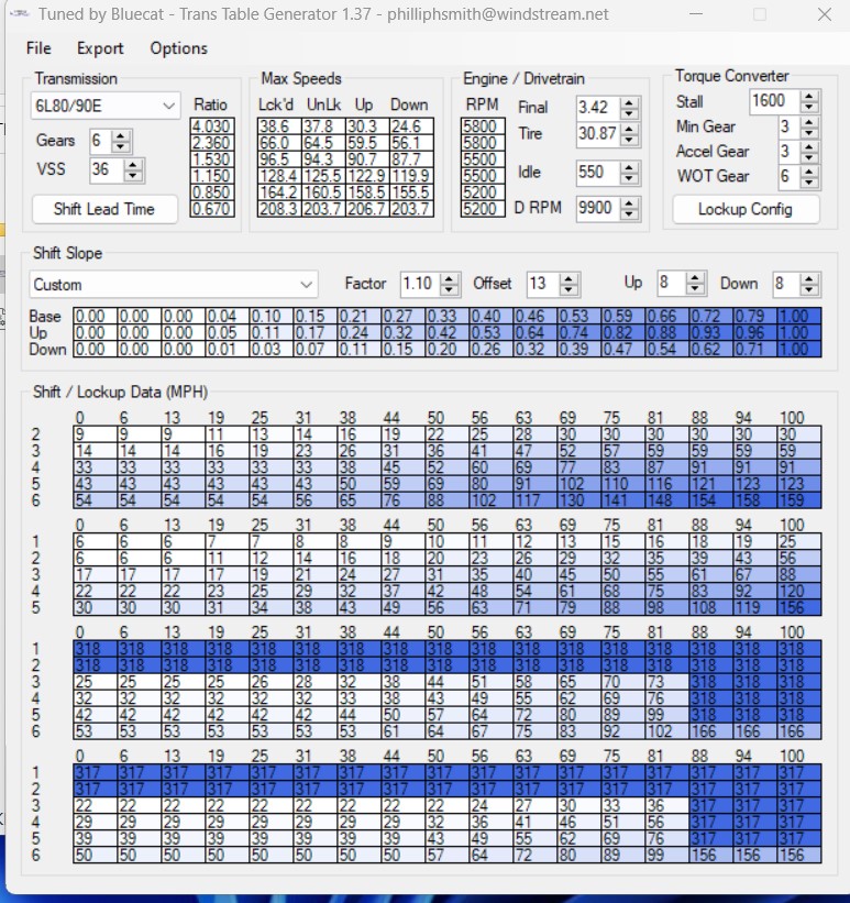

If you do a tune, the AFM can be disabled. I saw you mentioned some device at nearly $450 - at that price, spend a little more and get it tuned. I used BlackBear Performance to get mine tuned which eliminated the AFM feature (more like a bug) from the truck. They do ECU/TCM tuning - biggest thing I noticed was the trans was no longer searching for the right gear when driving up and down hills or grade changes.

I would have just got the BB tune. The Range AFM doesn't do anything to improve the transmission programming, which is most of the issue with these vehicels. Yeah, the AFM is dumb, but you can turn it off by shifting into Manual Mode - Gear 5, which is fine for around town, and up to about 55mph.
