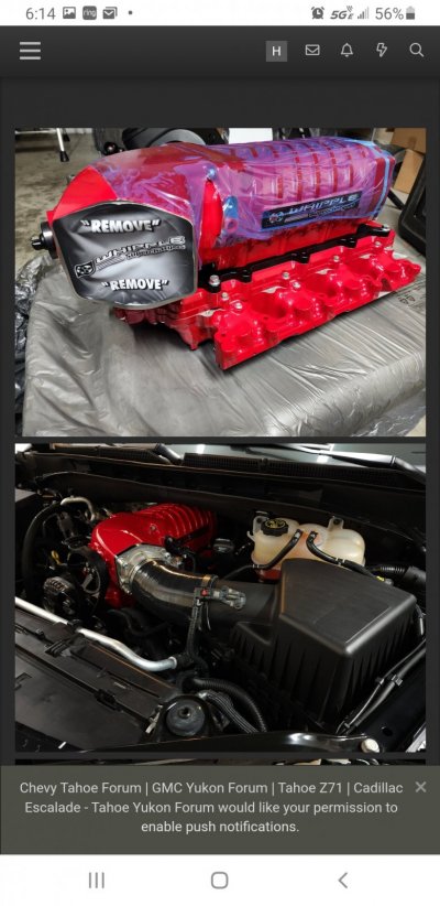

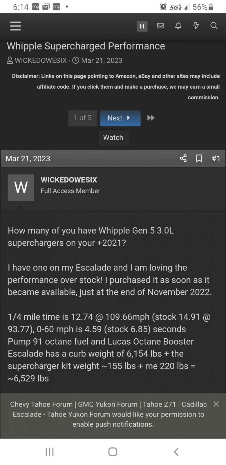

Wow, there's some really good info in your comment, I really appreciate it. Do you know if the Gen 5 3.0L Whipple will fit my engine? Only reason I ask is because I recently read a thread that had the Gen 5 Supercharger and it looked awesome!! I think it was on a 2021+ or something like that? It was red, vs there standard black, unless he painted or powder coated it?

Here's a couple pics of the Gen 5 3.0L Blower

the "gen 5" i believe refers to whipple's gen 5 blower....its has nothing to do with fitting GM gen 5 engines.
same engines for 14-current (15+ suvs)
trucks get L83/L86 engine designations, but they are similar to LT1/LT4 engines.... i think there are still adapters needed to run oem blower, doubt theyre needed with the whipple, will just need to make sure the belt spacing is correct i think it has changed throughout the years
the early version of the whipple for LT4s had some problems, seemed like everyone one of them always had excessive knock no matter who was tuning it, made a lot of GM (zl1/ctsv/vette) guys shy away from them and not come back it seems.
the other option is a 2650 blower, eaton rotors (oem for ZR1 vette LT5 blower), make lots of power, very effecient, great cooling
