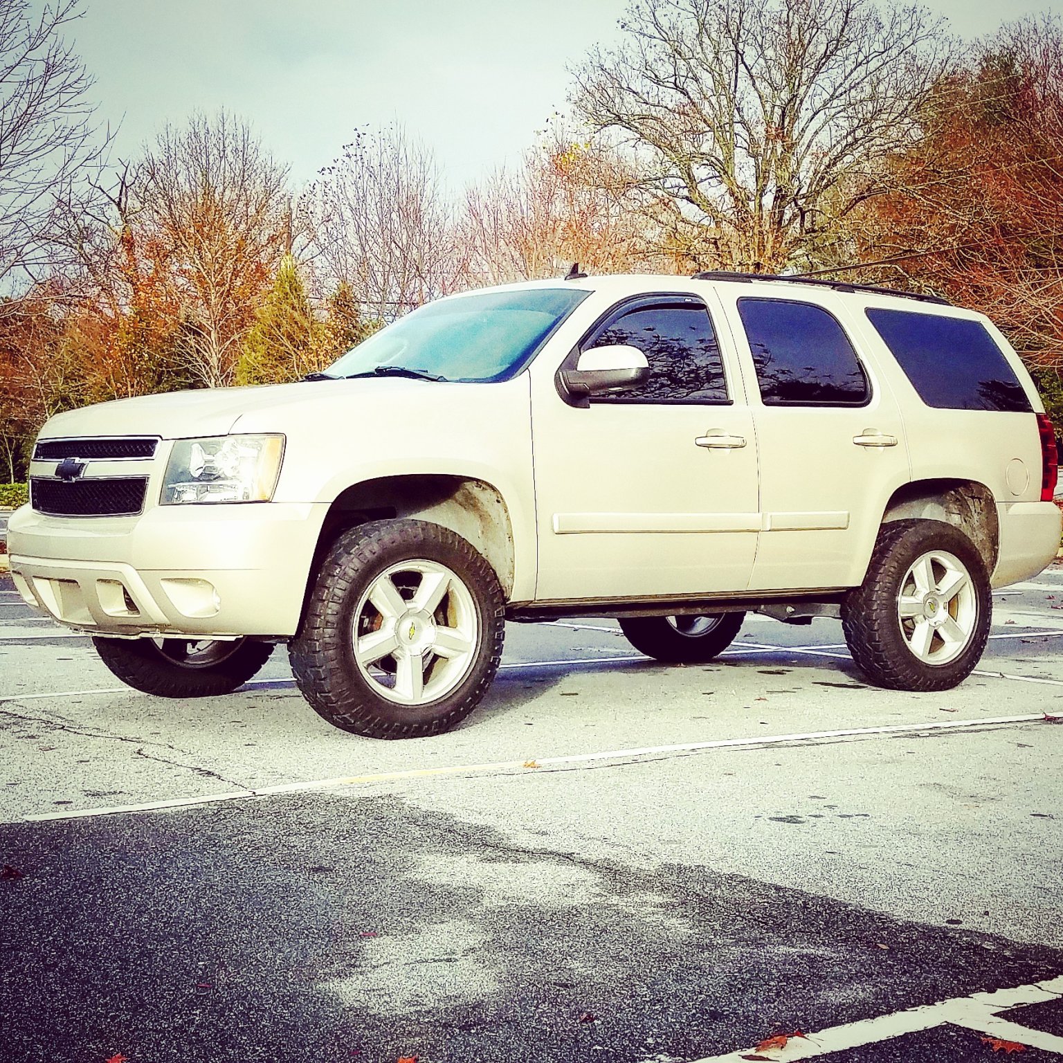

I just did the 5100s on top of a RC 2" front level. I also did Moog Springs and have a 1" rear spacer. My front 5100 struts are set on the first clip level up from stock.

Looks good. Exactly what I want to do, plus a body lift. How much lift did you get from being on clip one? Do you know the fender height and what size tires are those. Any complaints? Any front end suspension angle pics or

I got almost 1" from clip 1 (one up from the stock first clip setting). It rides a lot better than my shot autoride shocks and handles better in curves now. I'll have to take some pics of the angles but they are acceptable and everything from aligned correctly. I am considering aftermarket UCA's though for even better angles and more travel.
Fender measurements:
FR- 39"
FL- 39 1/4"
RR-40"
RL-40 1/2"

Thanks man. The Moog Springs are definitely stiffer than stock in the rear but it feels more planted. I don't think the preload on the front struts has effected ride quality much. It rides so much better than the broken autoride did. There is a lot less body roll in corners too.
