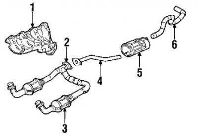

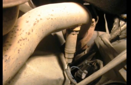

I have attached a few pics of the place i think they should be.
I would appreciate the help!

the first picture...you are looking right at one of the O2 sensor
second picture is so small...but looks like one the Cats to me just in the upper right of photo

yea that looks like one of your cats in the second pic and thats definately an 02 in the first pic, if your not getting any codes its because they are still there and running fine or if they are gone like you said someone tuned out the rear sensors. Alot of people (if you live out of california unlike me) do delete there cats and run straight pipes and tune out there rear sensors. but it looks like you might still have them

The sensors can be going bad and still not throw codes. If you have a code scanned you can watch the voltage from the sensors. If they are good both banks will fluctuate fairly close with each other in a rhythm. If they are bad they will bounce in different directions and do odd things.
