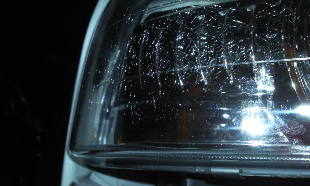

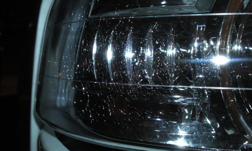

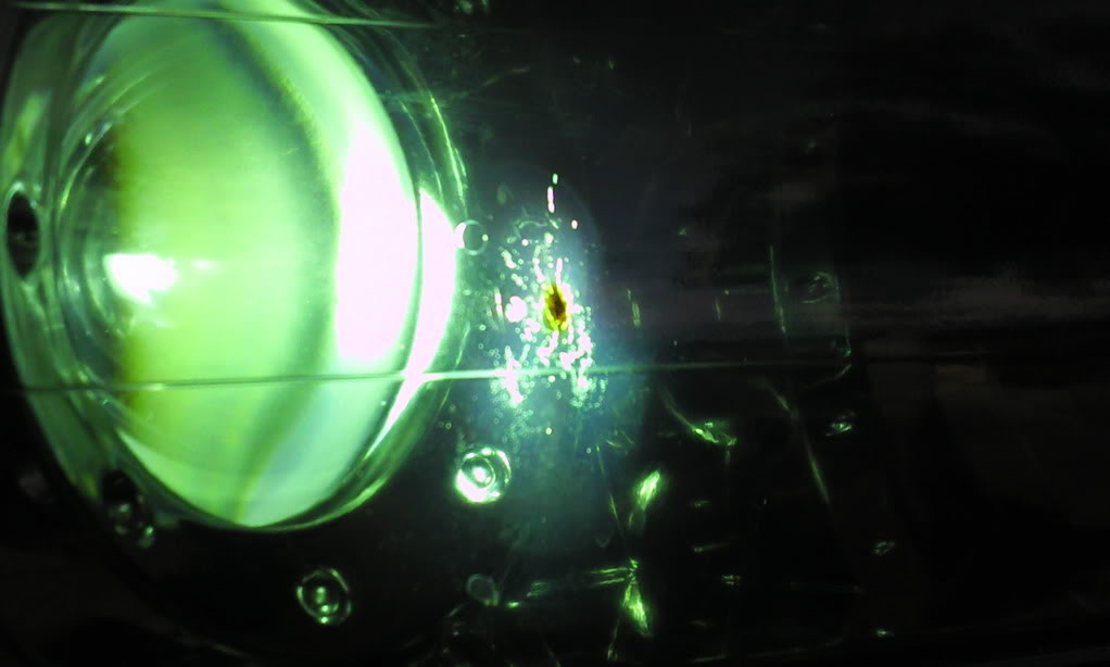

Anyways, looked at the headlights yesterday, and saw that the tinting has caused my headlights to burn/melt a spot in the headlight lens where the light goes thru, and also then caused the lens to start cracking. I know it's the tint cause I have had the headlights for quite awhile now with absolutely no problems till tint installed. Also it makes sense now thinking about it, cause HID-high intensity discharge, causes alot of heat and then putting a dark film/tint over the lens will cause a heat build up since the light can't all get thru. Here is the aftermath:
Here is the burn whole that was produced
Here is the cracking/spider webbing that happened because of the heat
