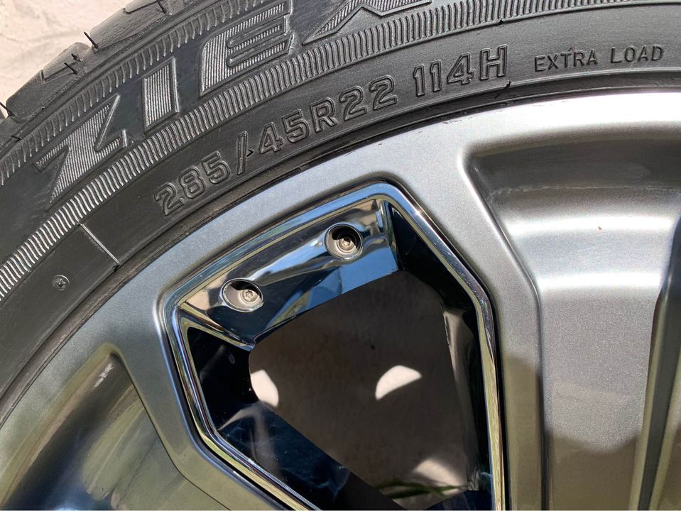

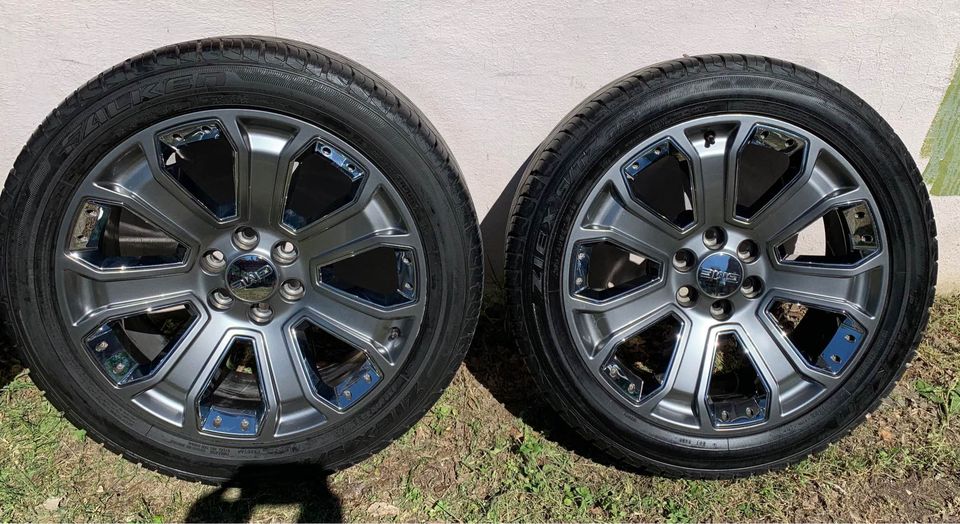

I found some used GMC 22" oem wheels and 285/45R22 tires. Will these fit ok in place of the 20" 275/55R20 currently on my 07 Yukon Denali?
Nice wheels!
They're very close in diameter 31.9" for the 20's vs 32.1" for the 22's, and very close in width: 10.8" vs 11.2". And having looked into this before, the offset should be the same.
Having seen others make a similar swap, I would have to say yes.
Murfs66
Apr 27, 2021
those will fit, but the offset is a little different and it might rub slightly on full turns when hitting dips. just trim if so. those are nice wheels
Joseph Garcia
Aug 2, 2018
7,346
9,930
Check the difference in wheel offset. If the difference is minimal, than they should fit. I run a 305/50x20 tire on my 07 with a 31mm OEM offset, and while the clearance is small, I have no rubbing.
VDV18
Aug 2, 2016
221
228
Grab them, no chance they'll rub.
91RS
Nov 15, 2009
2,588
2,033
GA
They will not rub at stock height. Tons of people use K2 wheels on the 900s.
