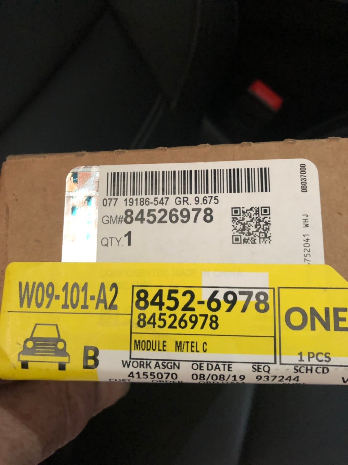

Wireless charging module update, GM part number 84526978 (plug/play harness)

There’s like 5 threads on this. The new charging module WORKS WITH THE IPHONE 8, X AND ABOVE. I still have one more for sale.

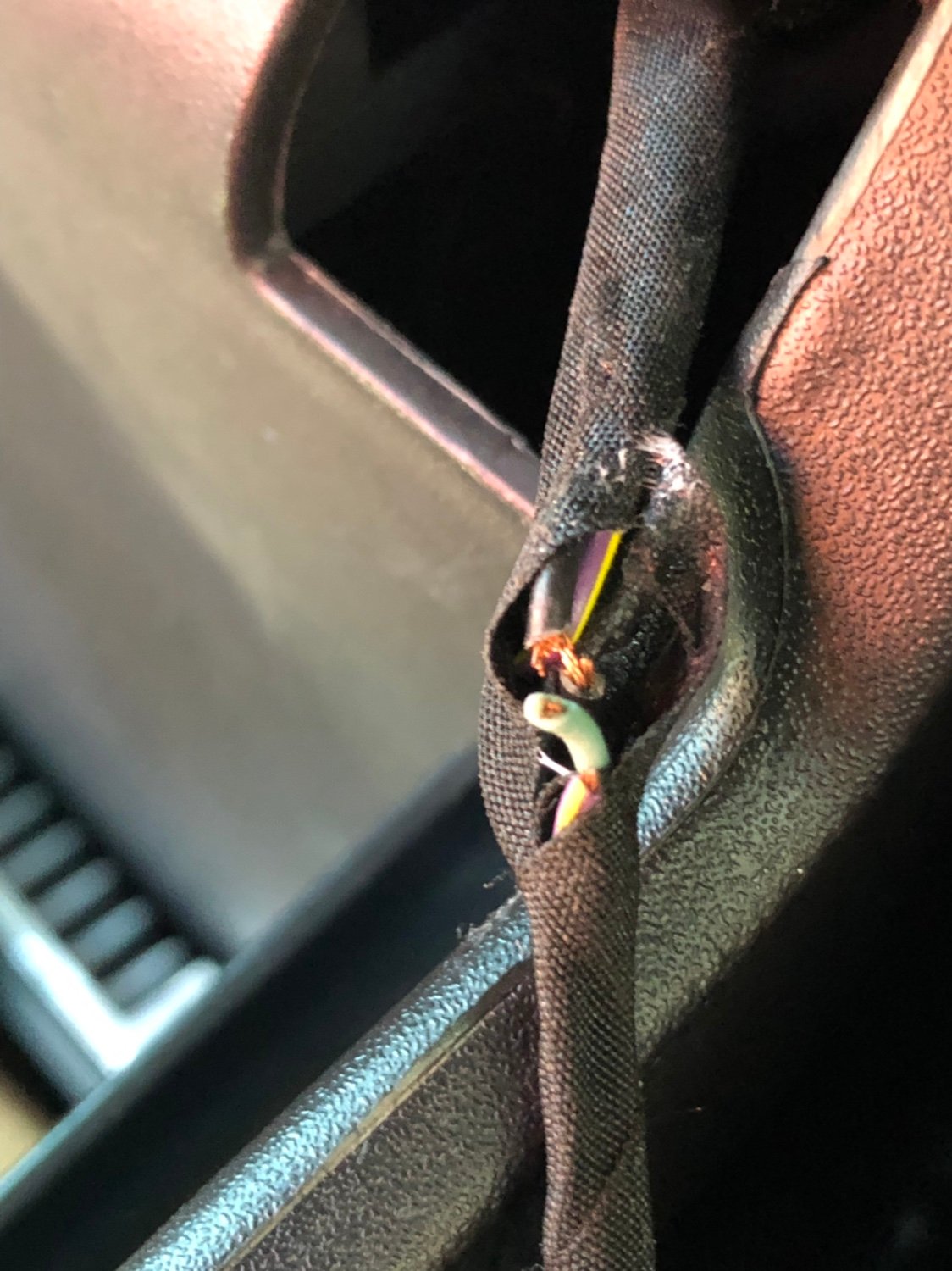

Anyone tried to install this on an LT that was not equipped from the factory with wireless charging?
I installed one on my 18 LT that came without the wireless charging. There were no provisions for the charger to connect to so I spliced into the 12v lighter in back of the console. It is powered when vehicle is on. Been using it 2 months now and charges my iPhone xs no problem. The charger comes with a cable that has 4 color coded wires ( Violet, Black, Green, Brown). Only the violet and black are used to tap into lighter outlet. The green is for indication on your infotainment screen that your phone is charging and brown is for fault detection. They are not needed/used for our application.
