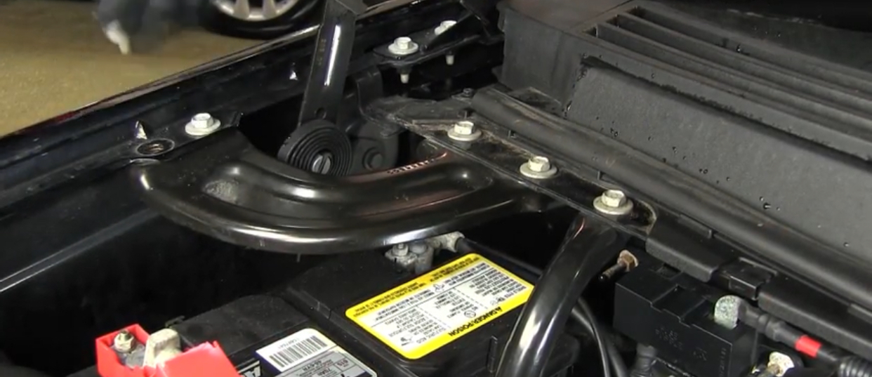

It seems I have no air springs or any of the fancy electronic stuff there. Just shocks and struts like most other vehicles. I have driven/owned heavy vehicles before as in several Tahoe's and Suburban's as well as Excursions and large trucks. Even added sway bars to the Excursion. But nothing of this vintage for the current Tahoe. I will be getting under it soon to investigate the sway bars/end links and their bushings.

New sway bar bushings and links came in today. Maybe get them installed this weekend. GM genuine parts.
