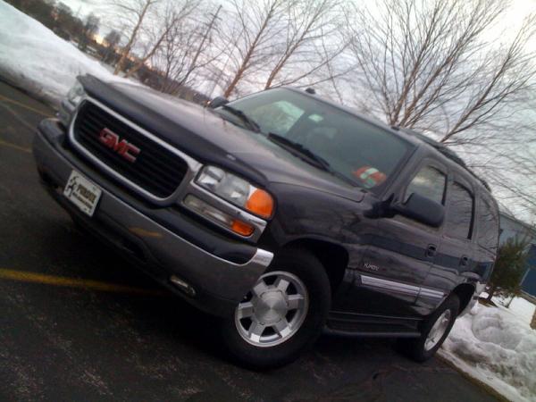

Wouldn't it be okay to lower w/o changing wheels?

bell tech 3/5 kit. by lowering it you lower the center of gravity of these truck and handle better. use shorter shock for the rear if you dont want your rear end to be bouncing on large bumps
