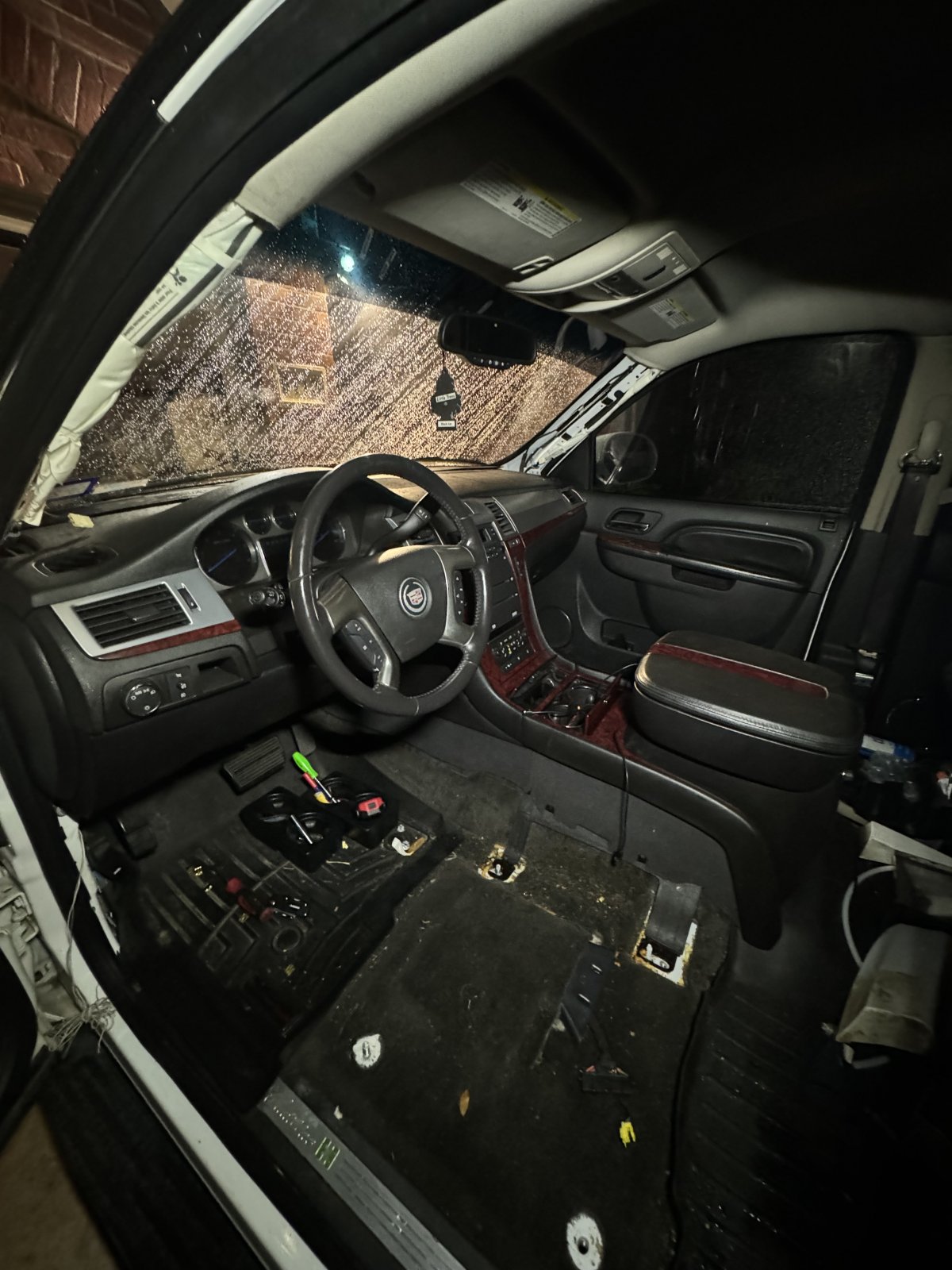

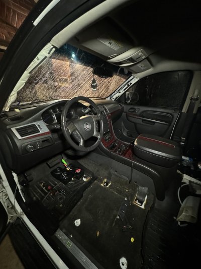

Feed us pics of Escal interior goodness. Still stuck in the bush?
