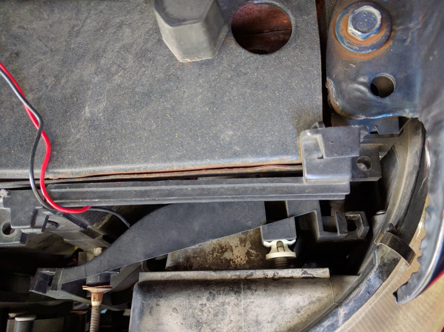

Well... so the grill installs!
However, yes the light housing brackets do not fit and neither do the fenders as the contour at the corners are shaped for the tahoe lights specific. If I didn't have to fork out for the bermuda blue painted fenders i'd have already ordered the brackets and duplicate black grill as seen on the Yukon. Maybe another day.. As for now i'm getting a set of black depos to replace the halo+LED lights that only accept an H1 bulb.. EDIT: I couldn't test the hood, however it *looks as if it would work.. would have to have the brackets mounted and lights installed to know for sure. Here's some photos:
IMG_20161011_135643.jpg IMG_20161011_141729.jpg IMG_20161011_141749.jpg IMG_20161011_142235.jpg IMG_20161011_142331.jpg

Theres a reason when people do front end conversions they get the entire front clip (fenders, hood, bumper, grille, light, mounting panels) because just some of those parts will not complete the job.
I dont know why youd want to change a Tahoe front to a Yukon unless youre doing a Denali. Tahoe front looks better all day long. You could say "yeah but nobody has done it", but in that case, just buy a yukon.

This topic was introduced because there isn't easy to find resources stating facts as to whether the swap requires all components and why - thanks for stepping in late.
The facts have been touched on a million times on this forum and GMFS. Ive been here since 2012, Been doing body work at a GM body shop since 2008, and Ive given input on just about all of them. As you've found - to do a conversion you need all the components to do it RIGHT. That's like saying, well, this seat from a cobalt physically fits where my drivers seat goes so it will work. Yes, but no, it doesnt. You need all the parts that have been stated for years.
