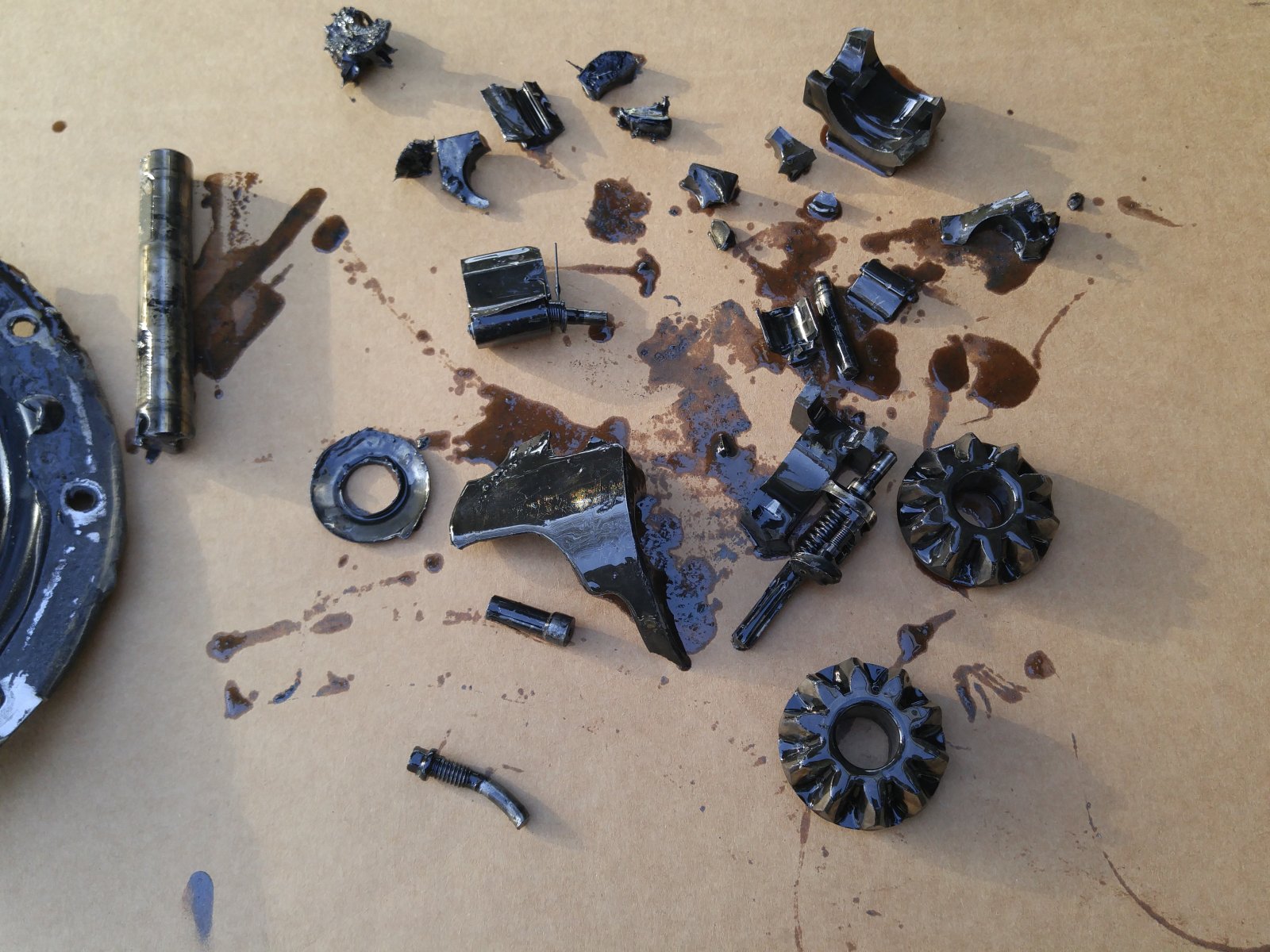

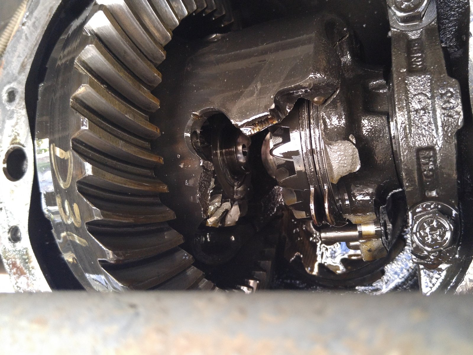

Well, opened it up and it is definitely the differential..... or whats left of it anyway
Big chunks in there. Getting it done today, $900........... but beats 2x that for a tranny........
This is pretty far above my pay grade, anyone have a guess as to what caused this to happen?

I had a crack in my diff body that is almost identical to the shape of what's left of yours in the last pic. I'd say whatever caused it be thankful it didn't grenade on the freeway, I was very happy I found mine before it did.

Cause? Likely age and mileage. You never said mileage I believe. Don't know the maintenance record on it either so maybe not taken care of with fluid changes in a timely manner?
Or your 10 second quarter mile launches at the drag strip had something to do with it. :chewie:

Hahaha no time at the drag strip for me.
Its got 180k on it. Not sure of the service history before I got it. However, the fluid didnt look too bad... still pretty transparent.
