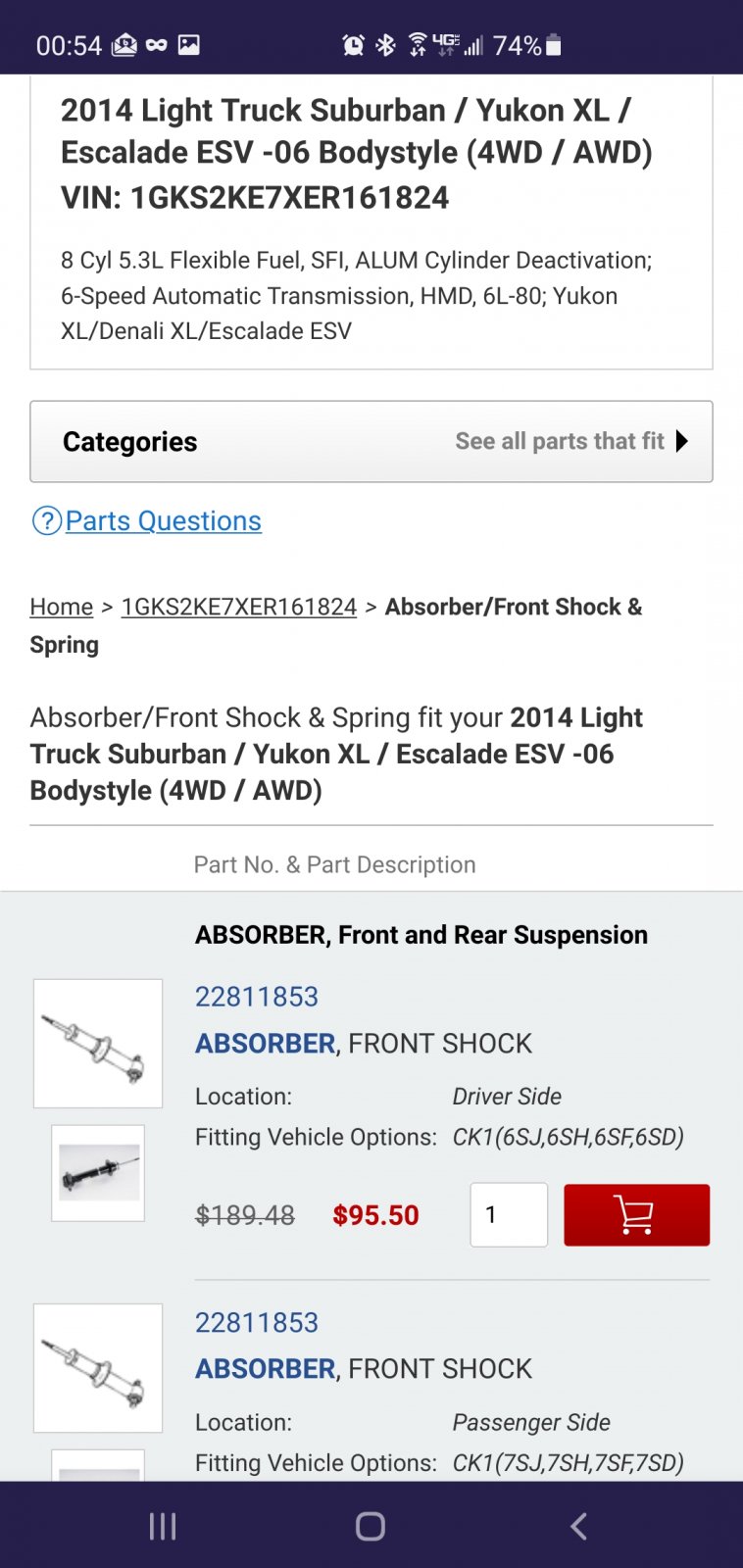

According to gmpartsgiant with your VIN plugged in this is the part numbers for the front and rear shocks and struts. You can also use gmpartsdirect and plug in your vin. I have noticed if I use gmpartsdirect and plug vin in it still shows me all options for other rpo codes other than mine. Gmpartsgiant seems to pull parts just for my vin.

According to gmpartsgiant with you VIN plugged in this is the part numbers for the front and rear shocks and struts.
Notice how this says from 2012 to 2014 also.

I take that back the numbers for the front do fit the 2014. So does the 22811853. Any 8dea what the difference is?
The numbers I provided after looking them up with your VIN and RPOs are for GM Original Equipment grade parts. The number above also refers to 560-707 so more than likely it is either newer or older than the one I provided earlier. GM often changes part numbers when they switch vendors or make even slight improvements. I wouldn't over-think it, just look at Rock Auto, Amazon and Ebay and see who has the best availability and prices with those 3 part numbers. More than likely, one of those GM part numbers is right next to the ACDelco number on the shock box and sticker. Rock Auto has a 5% off code on this website somewhere.
Unlike generic shocks, GM went to great lengths to fine tune the ride depending on our vehicle's weight because of how its equipped with options. A lesser optioned truck would require different shock valving to offer the same ride as a heavier truck. Mine weighs 5900 pounds on the CAT Scales and have seen a few on here a little heavier and a bunch a bit lighter and all have different valving but all used the same springs.
Are you doing the work yourself or having someone do it? That's kind of what I figured on the parts number change. Yes I am doing it myself.
