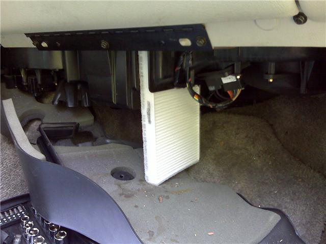

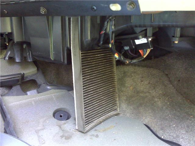

Alright, this is the 1st time I remembered to take pics as I did something to my truck. I found that this replacement is super easy. $16 at AutoZone and a ratchet. 1) remove the 3 screws holding the cover under the dash (above the pass. feet). 2) remove the screw holding on the cover to the cabin air filter. 3) replace the dirty filter with a clean filter. 4) put it back together. Very easy!
There are a couple of different filters you can get (carbon filter, paper filter, etc.) I went with the paper because it was cheaper but wondered if I would have smelled as many skunks on my last trip to Arkansas if I would have gone with the carbon. Dunno.
Anywho, here's the pics.

Great post bro, thanks for that. I have an 02 and replaced mine and the only issue I had was that I couldn't figure out which direction the air flows? Do you know?
