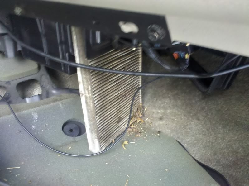

A little trick I learned for changing mine without loosening (or losing for that matter) that accursed screw up against the firewall - If you look at the filter trim piece, follow it backwards from the screw (as in picture 1 on the first post ) and up to just under the hinge point in the dash. You will see that the trim piece is held in with a simple tab / slot point. Work a thin flat head screwdriver gently into the tab and you can pop it out of the retaining slot. Dont try to force it or things are gonna crack, but it can be worked out slowly. This will allow the trim piece to droop, you can then pivot it on the screw and pull out the filters. Put in your new ones and then just snap the piece back in place.

Wow that thing was really dirty! Makes me wnat to run out and buy a replacement right now! I think this will be next weekends project for sure!

I have an '02 and mine was dirty as heck at 100k. I have changed mine out a few times since then. If it's your first time changing it out and it's never been done (or it's been a good while), you should put a plastic bag underneath the work area to keep all the debris from falling onto the carpet. I had leaves, a lot of dirt, and even moths in mine.
