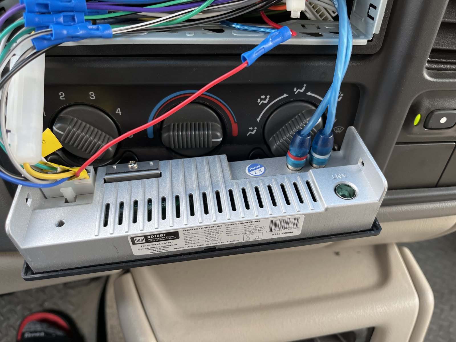

How is the sub amp input connected to the HU output?
C
Curtis12
Jan 6, 2024
9
Welcome to the Forum from NH.
Pics of the truck, please.

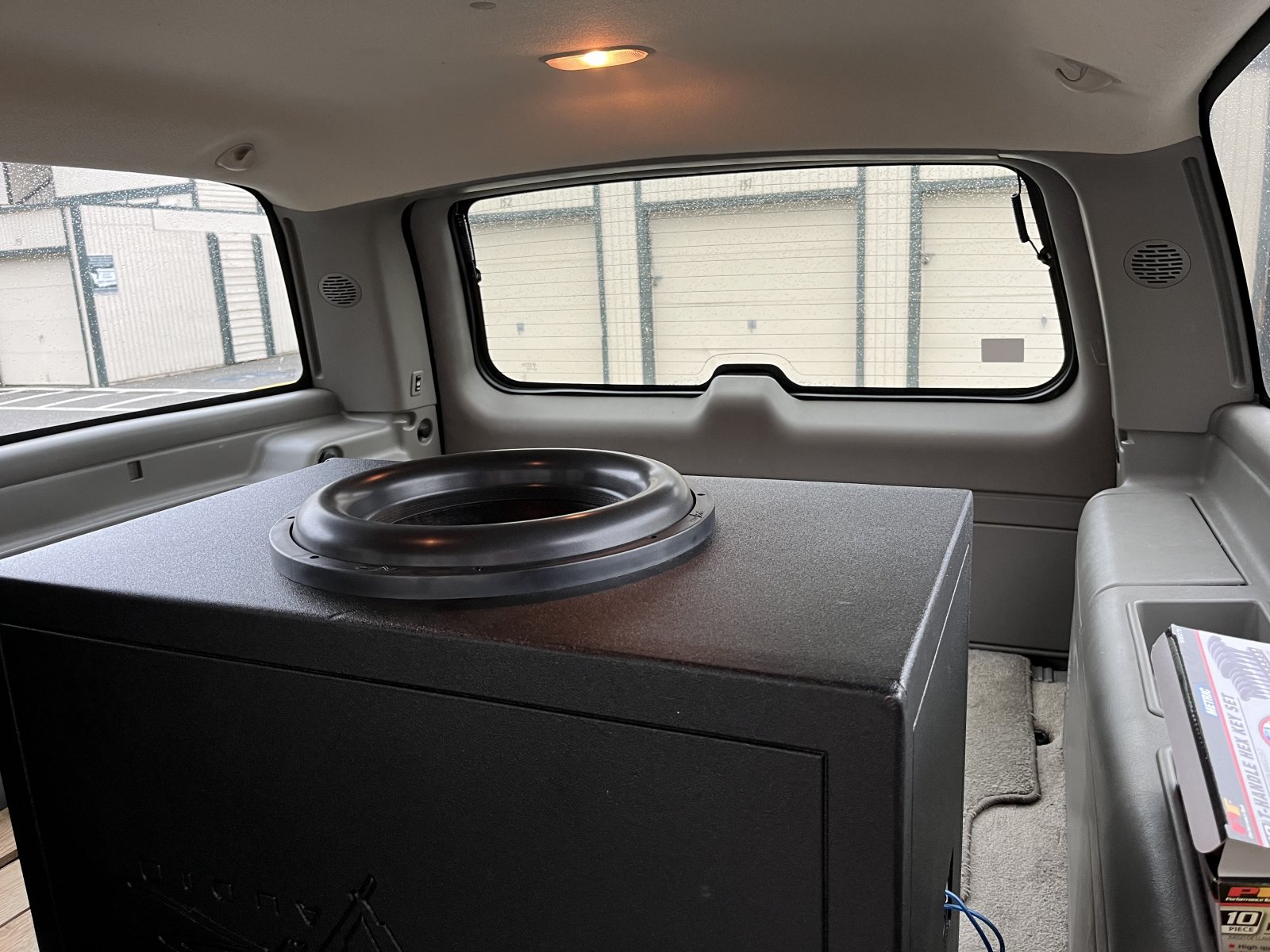

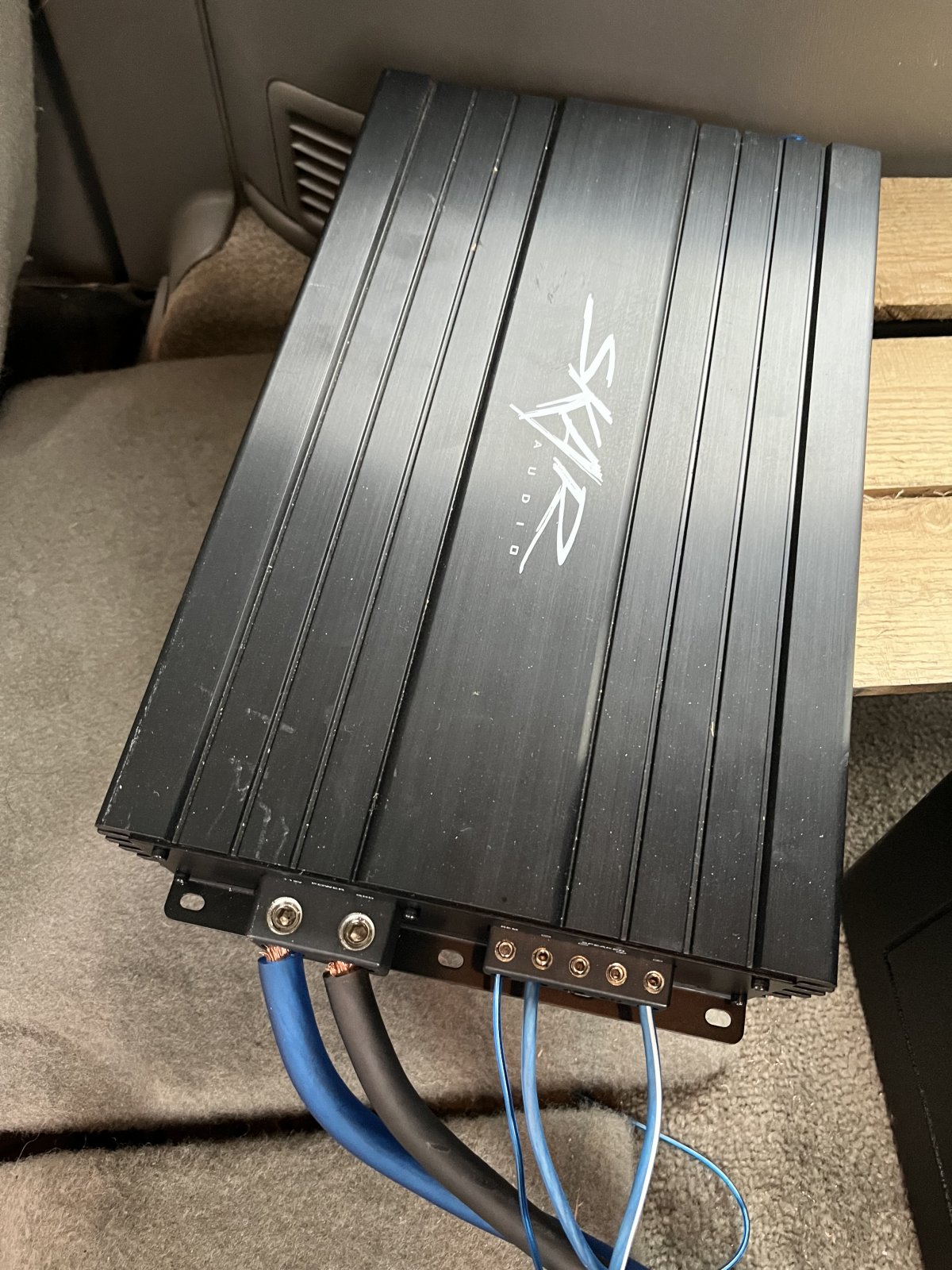

So the sub and amp aren’t really secured yet but they stay in place fairly well.

could be a variety of things or combo of things including
poor ground
not enough power
incorrect wiring
incorrect impendance
short to ground
double check your work
ensure the power wire and grounds are sufficient
cutting off and on typically is incorrect impedance, ground or power issue
