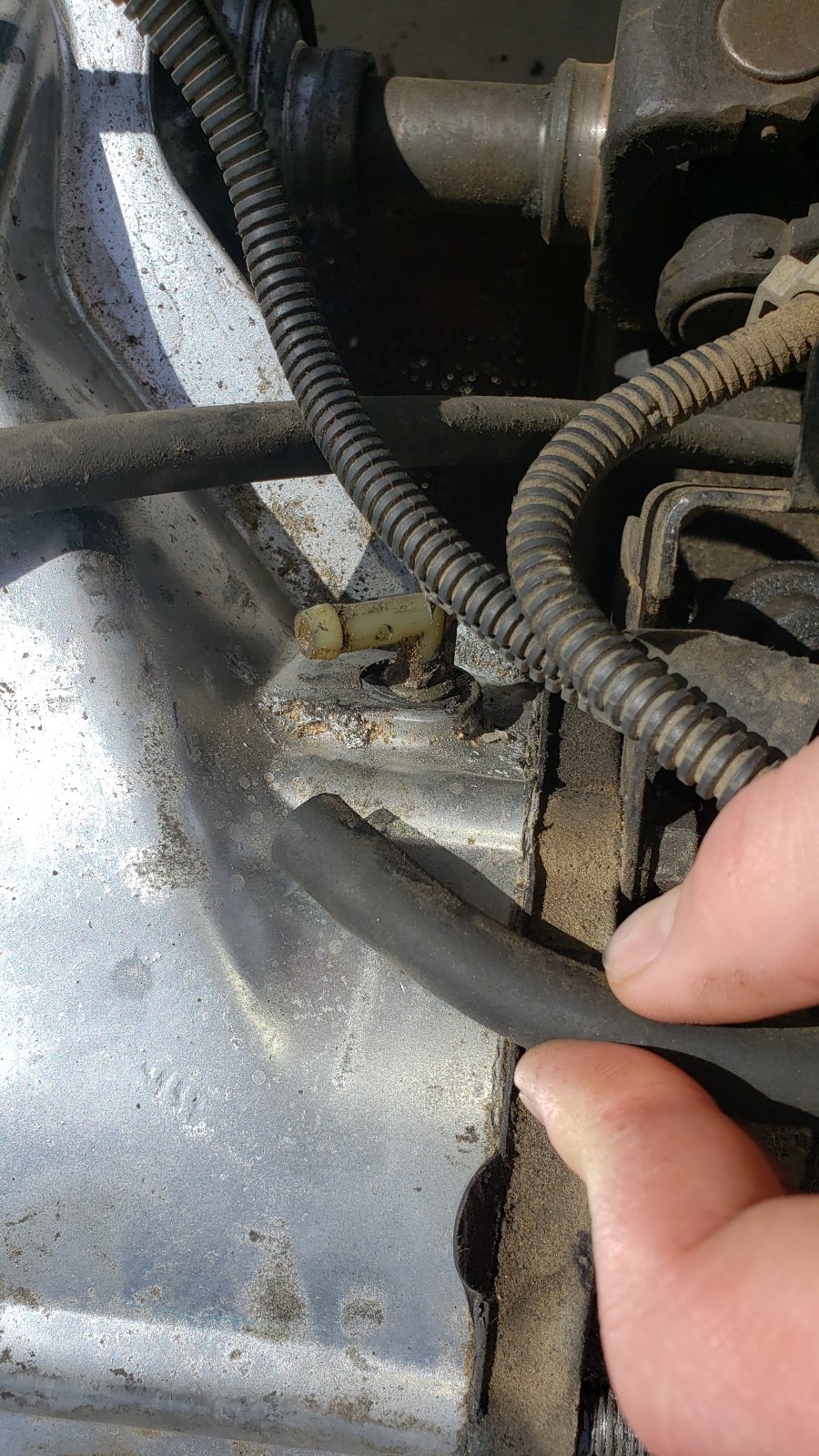

Hey I have the frame off of my yukon right now and I'd like to service as much as I can while it's easy to get to. I noticed the transfer case has been leaking, probably from the driveshaft connection and also it seems like a hose is disconnected (the red arrows). I'll include a picture and hopefully someone can tell me if everything looks alright, thanks. Also, what should I service before the cab goes back on? I definitely wanna refresh seals and fluids and do as much preventative maintenance as I can right now. Thanks

Those are breather hoses. It's normal to be like that.
You could do the pump rub mod. Will need to open the halves and change that, then put it back together.

Sorry my first picture isn't great, this plastic fitting looks like it should go into a hose or something
That hose on mine is attached to body may of pulled it off fitting when removing body but yes that's where it goes for vent.

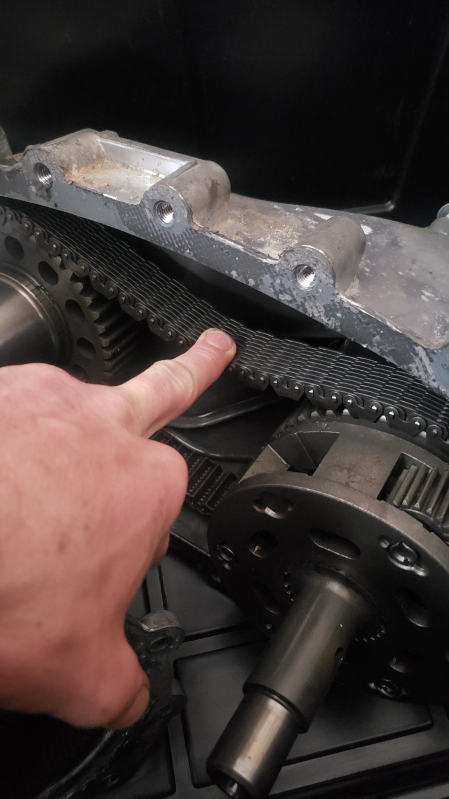

Thanks for the advice! Haha yeah, I'm not in the rust belt. I'm gonna do that pump rub mod, is there a kit that everyone likes and should I update anything else while I have it out? I think I need the seals for the drive and trans shafts... and is this too much play in the chain?20240227_152311.jpg
