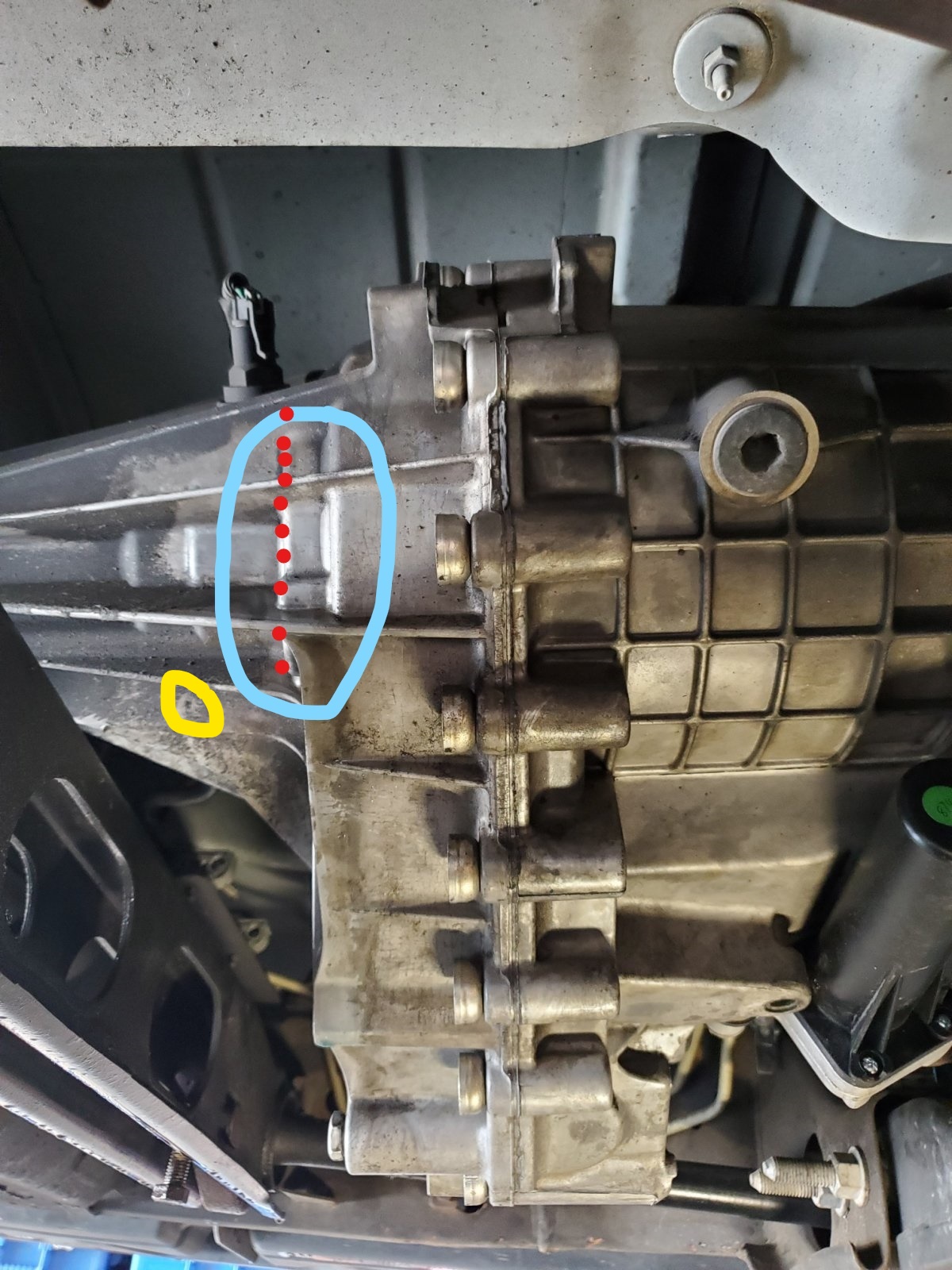

I have an NP8 246 transfer case and the shift from reverse to drive and drive to reverse is noisier than ever and the case is wet at the back and I do not believe it is the output shaft seal. I am convinced I have the pin hole leak problems. I knew it would show up eventually and I have reached out to @915_Tahoe for availability. The reman part # is 24228420 and new part # is 24240015. You guys know me. I will put a new one in but I would assume a NOS part would have the problem in it that caused the pinholes in my old one. If the reman part has addressed the problem, I would prefer that instead.
Any input from members would be appreciated. I am not looking forward to being on my back swapping this out but I believe that it can be dropped without having to remove the crossmember for the torsion bars.
I had been hearing a metallic slight pop noise at the back area, that I was sure was a loose sway bar mount or trailing arm. I crawled under there and could not duplicate noise with my girl power braking in reverse and drive. I can pretty much make it do it when just pulling out end of driveway where it is bumpy. I see no loose attachments at trailing arms, sway bar, shocks, transmission/transfer case mount, cross member....etc. This noise is separate and I plan to lay a wrench/socket on everything back there and check tightness.
The transfer case leak/noise problem was found during the other noise inspection. Oh well, another post in my build thread coming up.

Have you checked your fluid level?
Pump rub? You are replacing the entire unit, right? Ask the supplier if the pump rub kit was installed. I would assume so, but why assume if you can simply ask them? They also sell aftermarket aluminum case halves that eliminate the magnesium case.

Tcase Drive Chain could be stretched and smacking the inside of the case. Eventually it will chew through it. If you want to save some money a new chain runs around $100 and the pump rub plate use to cost around $30 and you can get them on amazon and ebay. You can buy a replacement rear half housing to replace yours too. You will need long nose internal/external snap ring pliers. The Tcase is very easy to take apart. What kinda cost are you looking at for a reman one?

I have priced a reman t-case, rebuild mine with the components you mentioned, $695 and I would be taking out and reinstalling.
Yesterday I crawled under and sprayed down the back half of case and found no pinholes. The output seal has a factory seep hole on the little collar/boot that is around the driveshaft snout. I squeezed from both sides and pushed down and no fluid came out. I am going to drive for a week and then put the Tahoe back up on ramps and look at the case and see where the fluid is coming from. It was never drips. It is seepage of some sort.
