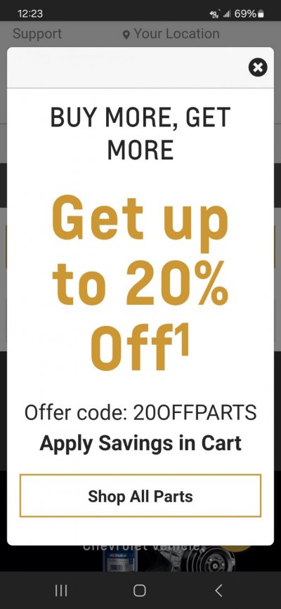

Sometimes the dealers have coupons off service too. With this coupon $3742 for gm and ends up being like $2900 give or take tax. Have them do the rear main seal too.
