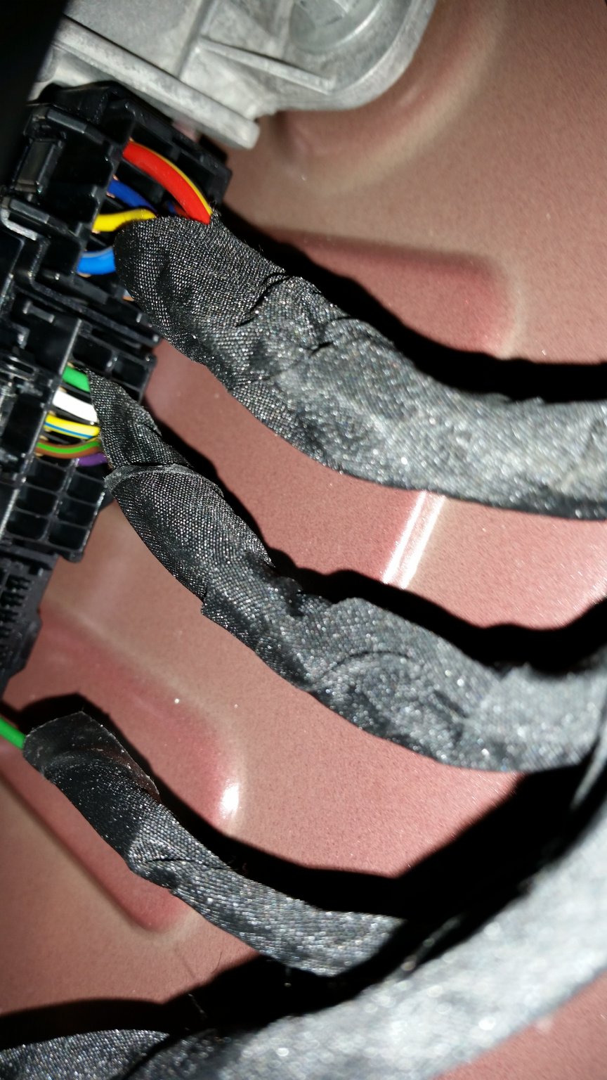

Here is where you will get your sub audio from, pins 1 and 5 the top connector on the BOSE amp. Also if you look at my Audison Full active post there are a bunch of pic's

On the output side of the amp in the back left of the truck. All your signals will come post amp, preamp is MOST / GMLAN29

Pre is all digital so you will have to get it post. You have an LTZ so you might have the 10 speaker system and noise canceling mic's. You might have to disconnect mic's due to feedback and you will have some additional outputs on the amp output harness. Your amp should be in the rear, pull the jack cover off and it should be behind the fuse block.
