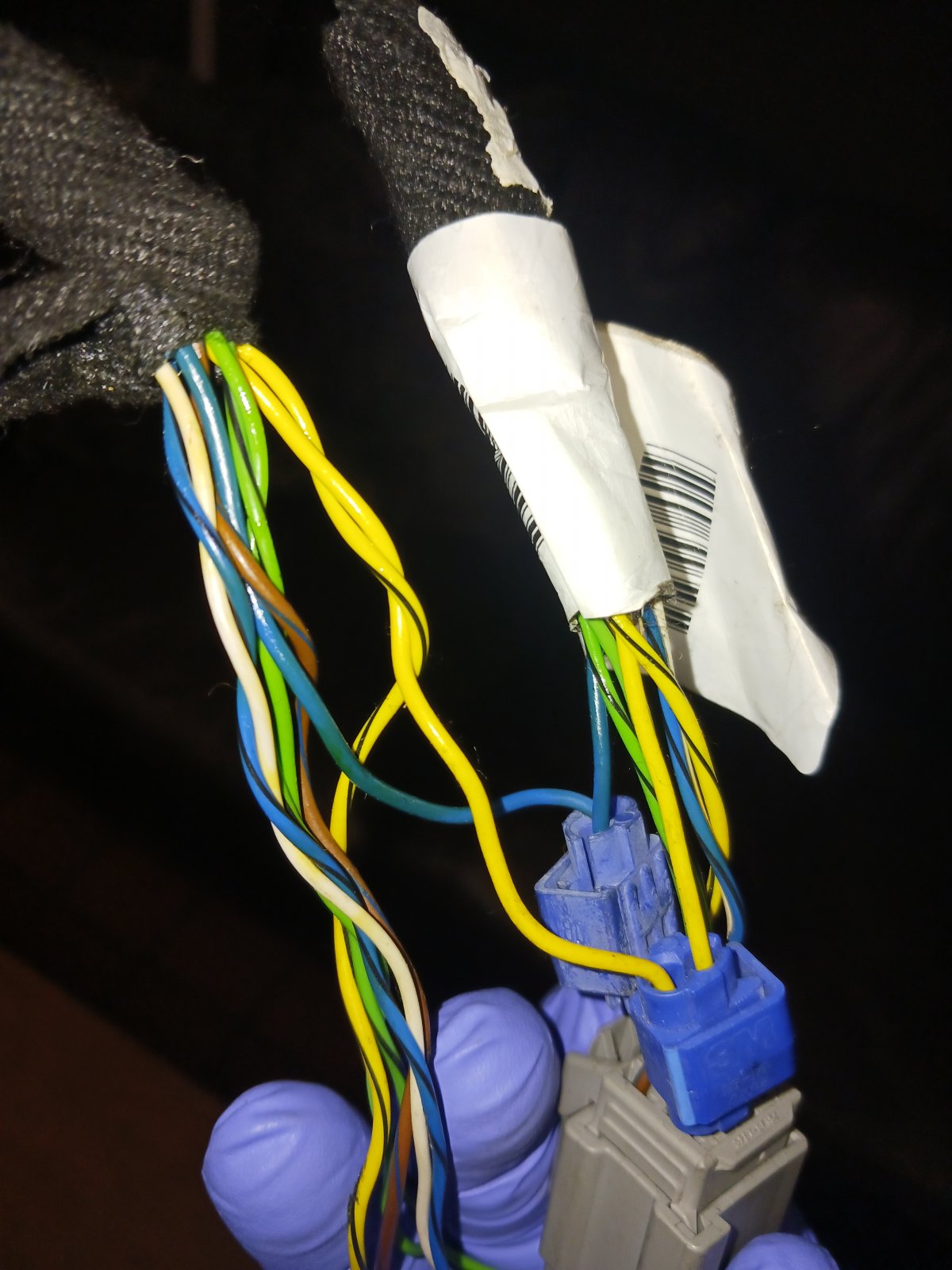

the horn is likely the 6J4 circuit in the center console area upfitter harness. Its a single pair wire that is supposed to loop back on itself. They cut it and run a rocker so they can select either the horn or the HORN (aftermarket). Here's a thread that should be helpful: https://www.tahoeyukonforum.com/threads/15-tahoe-ppv.137696/post-1782543
Thank you SO MUCH. I haven’t checked the form in awhile, saw this and immediately went to work after I got off my job.
Couldn’t find the 6J4 tag but I dug into the pin tail between the seats and lo and behold the two (brown wires with white stripes). Spliced them together, and the horn works.
I can’t thank you enough for pointing me in the right direction.
While I’m writing this, you don’t happen to know anything about the high beams? I can hear the relay click in the hood fuse box, but no dice.
Also, it’s interesting that my horn works on the press and key lock, but the alarm button on the remote doesn’t trigger anything.

I would guess the high beams were cut for wig wags at the connectors under the hood. That's where I'd start. I'm glad I was able to help you with the horn! With the issues you've had, it would probably be worth pulling off the front bumper cover and removing the headlights. You're probably going to find other extra wires under there you'll want to get rid of anyway. I had to pull mine to get the siren out and it came with about 10 extra pounds of wire and loom, and misc brackets
