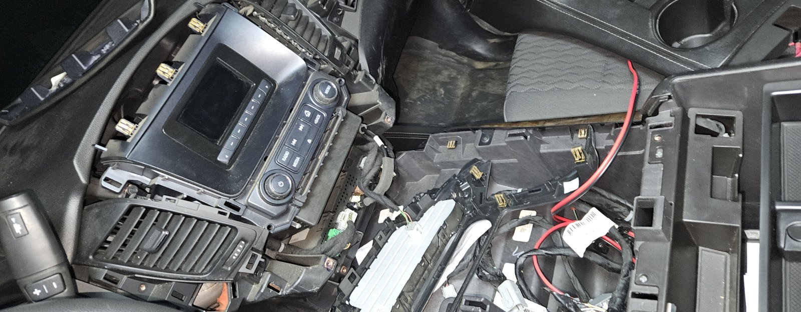

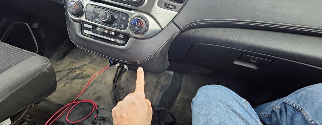

Just picked up a 2016 PPV from the auction. It doesn't have a center console. I picked up a 2016 suburban center console from the junkyard.
I am trying to install it and it seems I have to remove the bottom trim of the environmental controls for the rear. (See attached pics) Anyone know if it's only held in my clips or is it a more complicated process? Anyone have detailed instructions?See pics attached

haven't seen the conversion done personally, you might dig around on the forum a bit more for other threads with pictures or details. or try one of the silverado forums as people have added and removed center consoles more often, should be pretty much the same process
as for the radio you just need to add a module like a maestro rr. if you look on there website they have a click-thru build process for what you want to do.

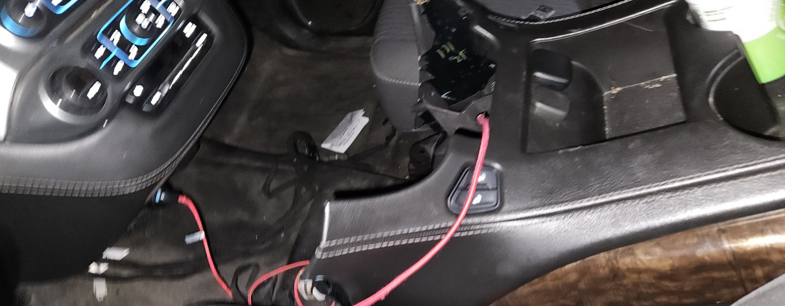

Just got the center console installed. Need to find bolts to secure it to the front dash and floor between the seats.
ryansclzo
Feb 17, 2024
what did you do for the wiring? The console has a X300 42 pin male connector on it, and my tahoe doesn't have a female connector. I think they cut it off. Did yours have it or did you wire it up yourself?
E
ew1046
Mar 23, 2024
8
I extended the dash cigarette lighter plug from the dash and wired it to the lighter plug closest to the driver. I can probably wire up the consoles rear plug at a later time.
I was unable to wire up anything else (cooler, radio control on rear console not working)
Yesterday I changed out the factory radio and installed an aftermarket radio with the maestro interface.
