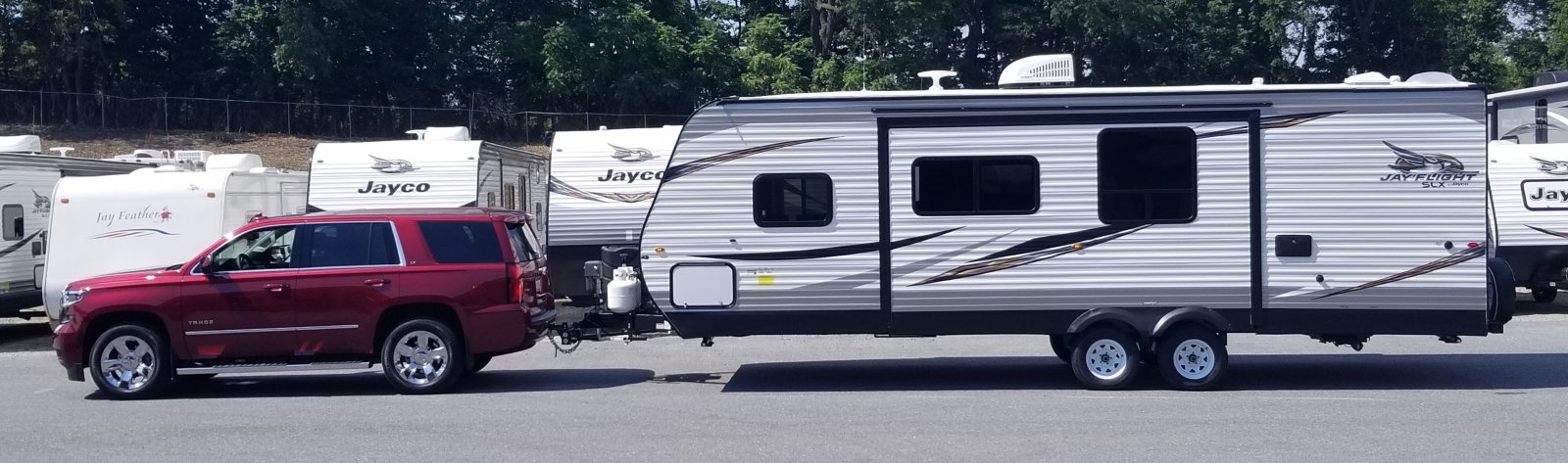

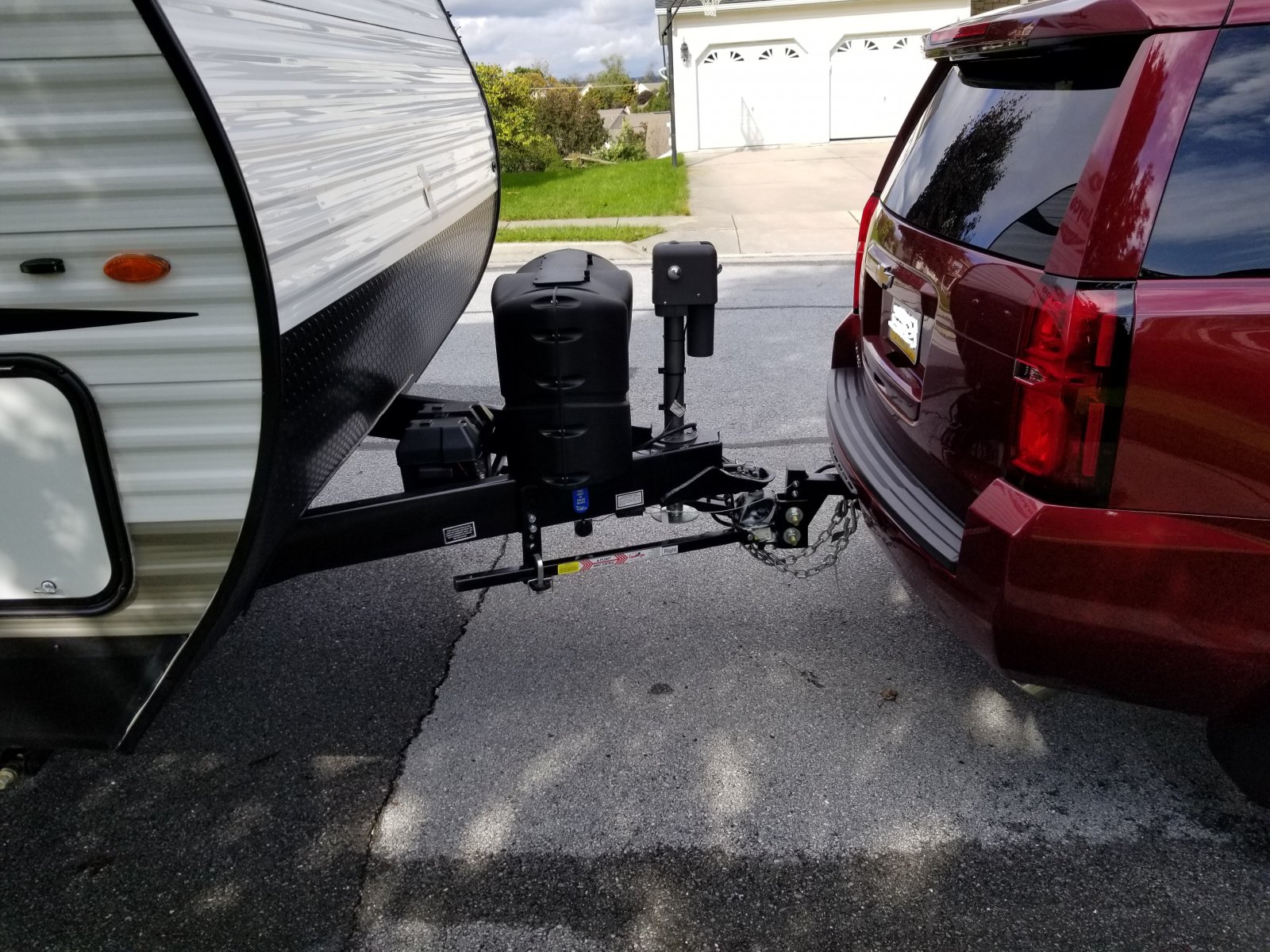

I have a 2017 Tahoe LT with Max Trailering. I purchased to specifically tow my Travel Trailer (5,850 dry weight). Last I hit the scale, my trailer was around 6,200 loaded and have no problem towing. I use a good weight distribution hitch and keep it at 55-60 on the highway.
The Max Trailering Package is important because you get the 3.42 gears, break controller, sway control, heavy duty cooling, heavy duty suspension, etc
Furthermore, I went with the Tahoe LT vs Premier because the LT has Air Leveling Suspension vs the Magnaride. When I hook the trailer up, the Tahoe gets itself nice and level automatically.

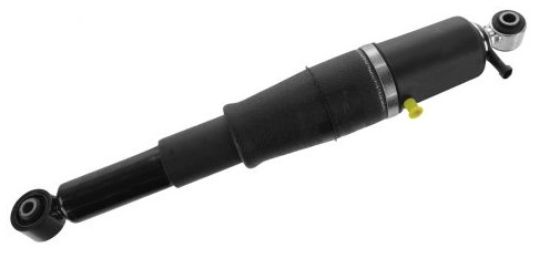

Can someone take a picture of what the rear auto-leveling suspension looks like? My Monroney label shows that I have the Max Trailering Package...but my rear suspension looks to just be standard spring and shock. I am not seeing any bags back there.
Is there a Max Trailering Package with everything (break controller, 3.42 ration, etc.) and not rear air?
Thank you!
DWTahoe
Mar 4, 2016
203
91
Colorado
It's hard to see anything different. My picture didn't come out well enough to be helpful. There is a little arm with a connecting rod that you will see in front of the rear tire. I also think there is a compressor/air line that you can see attached to the "shock" when you look behind the tire toward the back of the truck where the shock is. You can also hear the compressor turn on every once in a while, especially if you put 3 people in the back seat. And when they get out and you turn off the tahoe, you can hear the air release from them to let the back end lower back to regular height after getting out.
