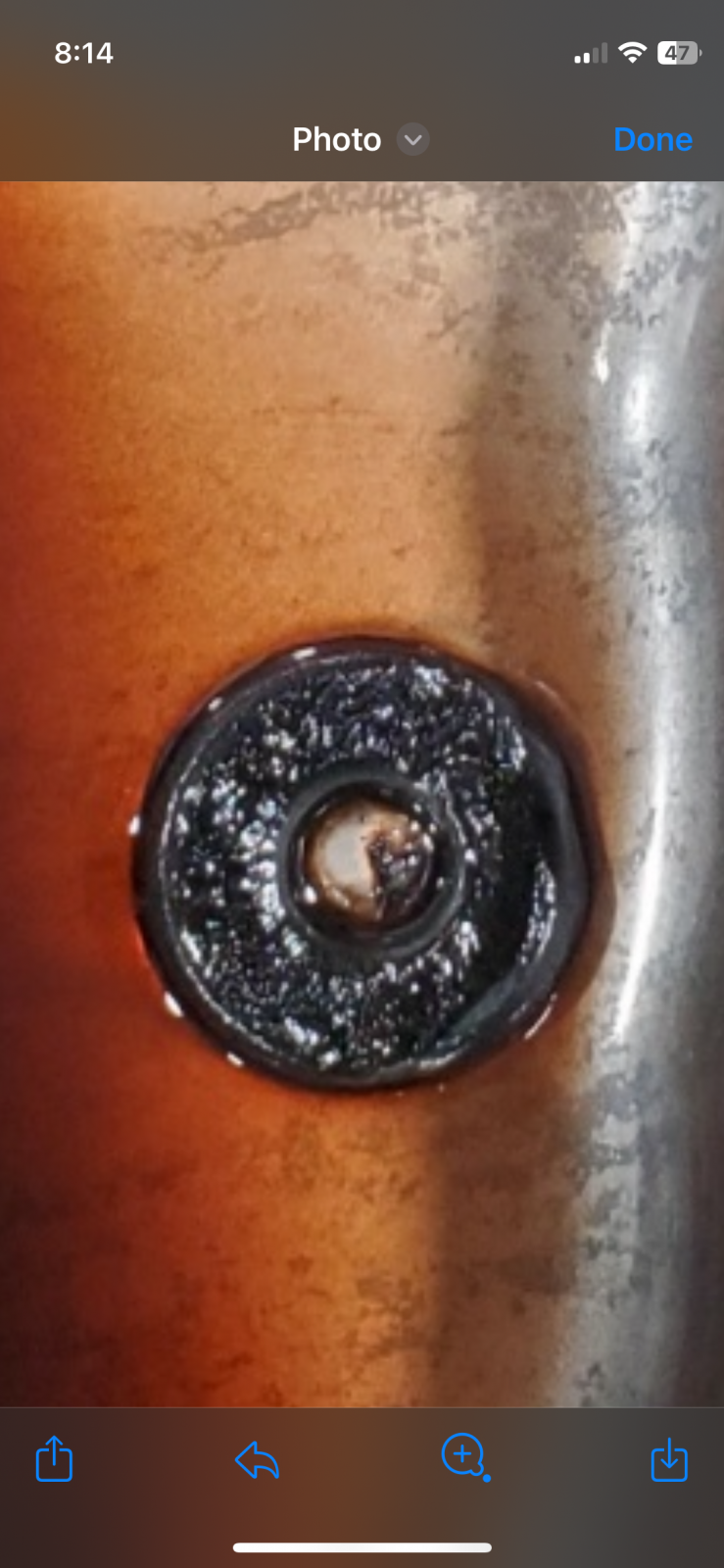

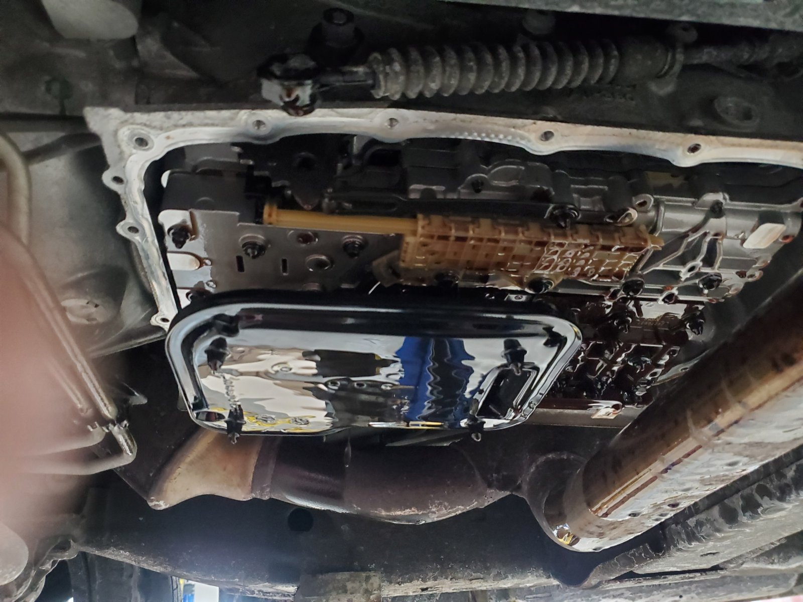

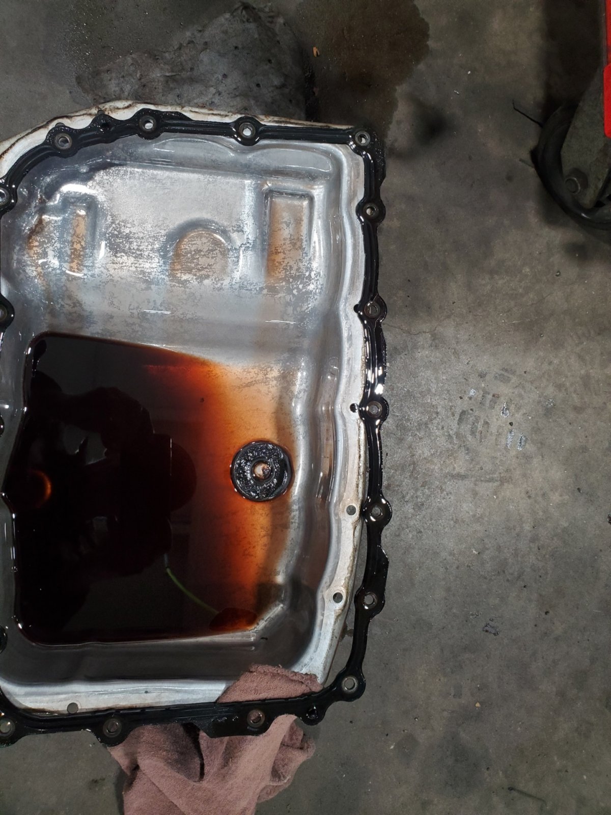

The next day I get a picture of the pan and underside of the transmission with a message of everything looks normal, no metal, we are currently deciding what to do. A little while later I get a message they are going to replace the torque converter.
This all just seems odd to me, what did I miss here? if everything looked good, then why would they replace the TC? If the TC has to be replaced, should I then be concerned with the transmission or any other part associated with the transmission? Do dealerships typically replace it with the same original faulty TC or is there and updated TC now? This is something I plan to ask when we pick it up. I have posted the pictures they sent so you more knowledgeable individuals can chime in and educate me.

45K miles should not be overextended for a trans service.
Trust your gut on this one friend.
From the crappy pics they sent, it does look like metal on the magnet and the fluid is more brown that red, indicting it its burnt. I bet is smells burnt too.
I don't know if there is an upgraded replacement torque converter or not, but most likely will be replaced whit the same part.

No, I don’t believe I need any specific information about the vehicle. I was more looking for opinions on what I should take from the conversation with the dealership. Yesterday they claim no problem at all and refuse to drop the pan. After persisting they agree to drop the pan but say everything is as it should be. Then they are replacing the torque converter. Seems like I might not be getting the whole story and want to know if I should be concerned with more potential problems. Do the pictures indicate anything other than normal wear for a vehicle with 45,000 miles?
