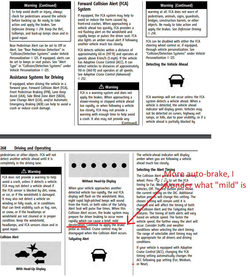

Was doing some winter camping/towing this week.... 2wd driving down a high-quality, 65mph, dry, 2 lane road on Adaptive Cruise at 67mph. Nothing in front of me but oncoming traffic/rows of 18-wheelers and cars whizzing by in the opposite direction when...
Suddenly, a sharp slowdown occurred, like stepping on the brakes suddenly/firmly. No skidding, but strong enough to pitch me forward a little in my seat. Significantly sharper than one would normally apply the brakes. I was just mouthing to myself 'what's going on' when it stopped - so just a few seconds. Slowed from 67mph to maybe 50mph before it let go. No alerts on the computer or screens that I noticed - was watching the heads-up display at the time. Didn't re-occur the rest of the 500 mile trip.
This is seriously concerning to me, especially towing and don't want a repeat! So I'd like to understand what may have happened.
Could this be adaptive cruise control mis-reading vehicles whizzing by in opposite direction? My experience so far with adaptive is a gradual slowdown - nothing like this.
Maybe I or they got close to the centerline? can this cause any kind of un-commanded slowdown?
Any other ideas?
Got my used 2021 last August, so still pretty new to Yukon Denali world, and thanks in advance for any thoughts on this.
