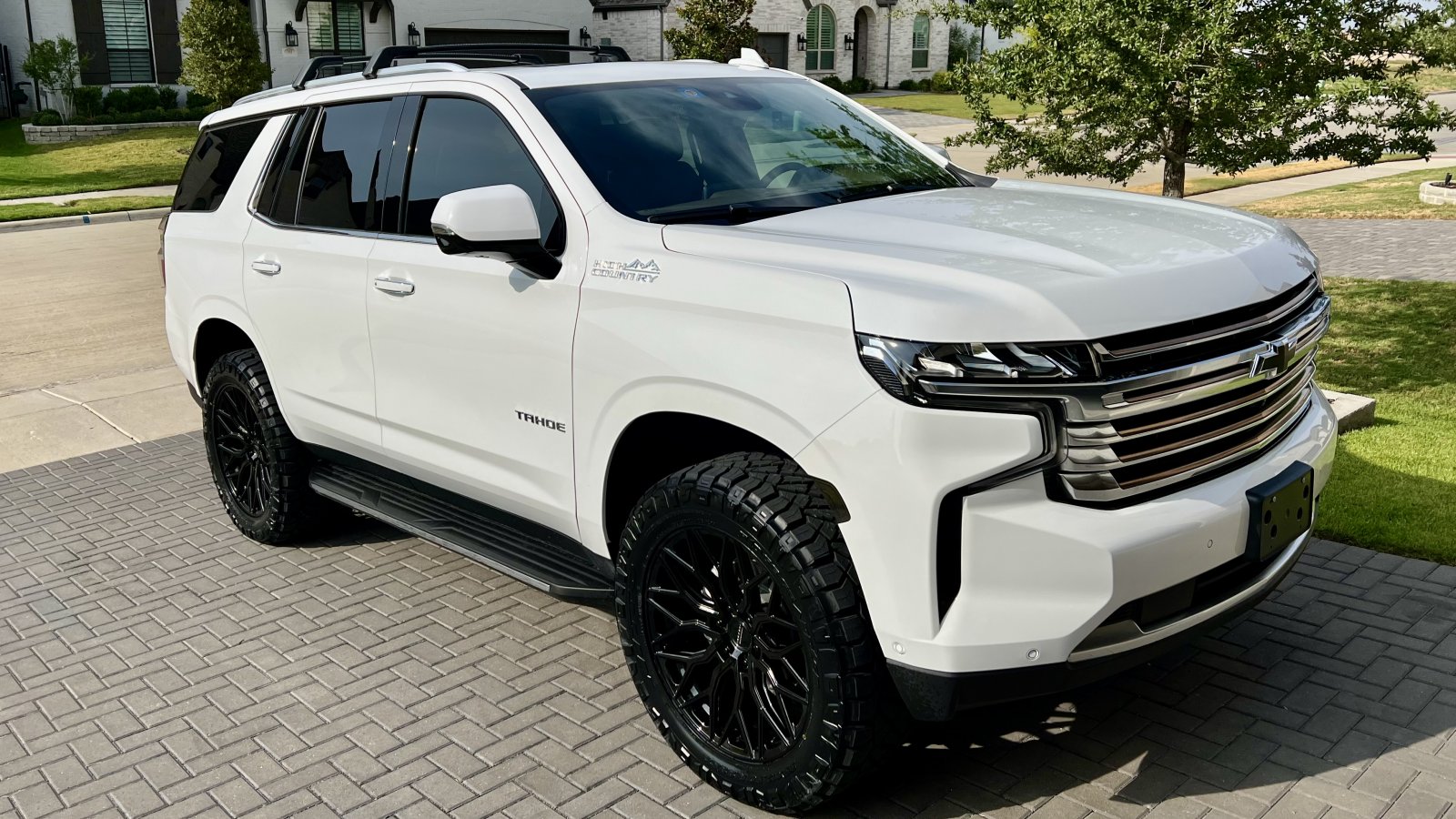

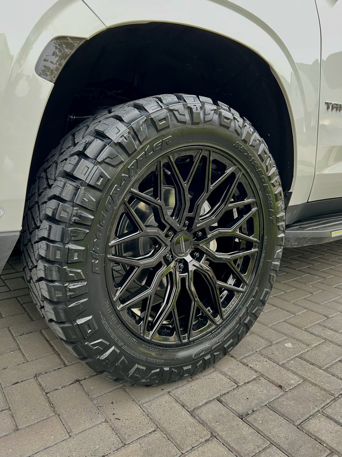

Wanted to share since I looked at a lot of posts on here to get an idea of what I wanted.
Autoplex Customs in Dallas did the work
- 2023 High Country w/ Air ride suspension
- 2.5" Autoplex custom air ride lift and level
- I know they used custom order links but I'm not sure where they got them from
- I would suggest reaching out to Scott at Lewisville Autoplex if you have specific questions
- 35/12.5/R22 Nitto Ridge Grapplers
- 22x9.5 Vossen HF6-3 Wheels
Yes they had to trim some of the front to get the fit but it doesn't appear to be very much and there is no rubbing at all. The ride seems to be a little stiffer but it is way better than even I thought it would be.

Looks great. Can you share a picture of the trimming to the front fender?
Also do you know the offset on the wheels?

View attachment 408630View attachment 408631
Hey I was wondering if this lift messed up anything with the ride computer? Does it still have cruise control capabilities? Or any lights on in the dash?
I'm leaning towards doing this exact set up, but instead of the lift links set at 2.5", have it set to 2" and nitto trail grapplers that are the exact same dimensions as yours at 34.76 x 12.52 and vossens at +20 instead of your +25....at 2.5" lifted on the air suspension, when you push the height reduction button, does your car Lower back to the "normal ride height"?
